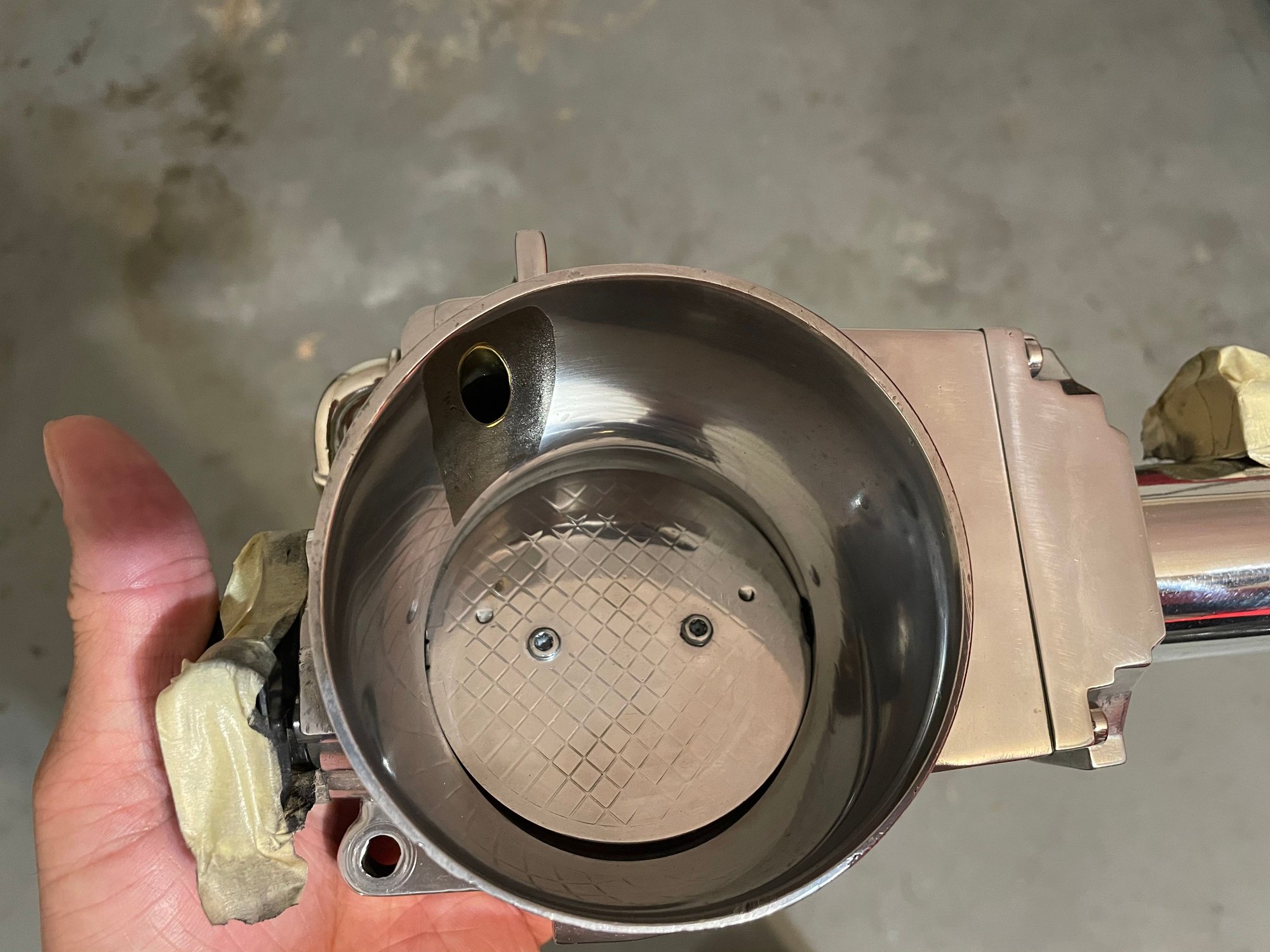

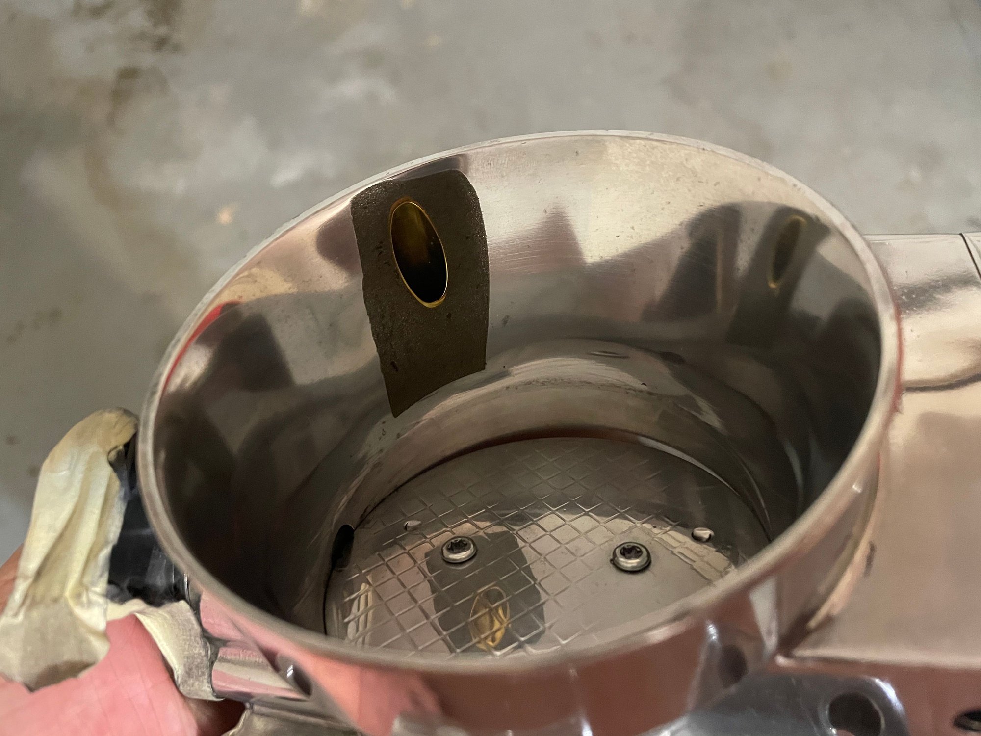

Porting and polishing your stock throttle body can be professional done for about $100 to $125. A ported stock TB is much more capable of performance and throttle response than most will lead you to believe. The same can be said about the stock OEM intake from 2001+. I still run my stock ported and polished OEM throttle body and 2001+ plennum on my car and it makes 634rwhp/568rwtq. Prior to the procharger it made 428/398 with heads/cam/Vararam intake and that same ported and polished OEM TB and 01+ plennum.

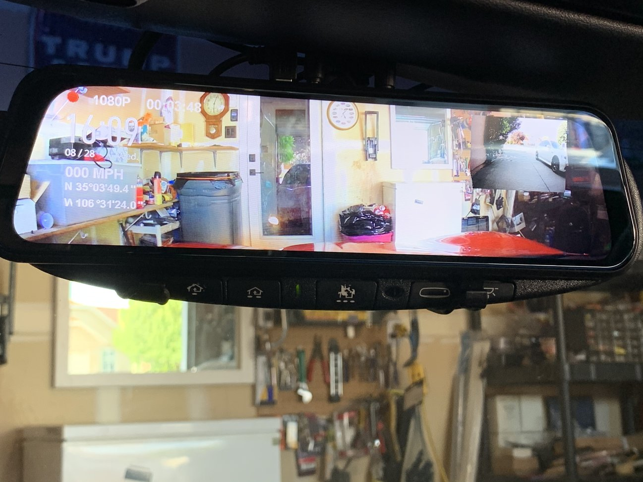

I've come back to you again because of the things you've mentioned in your last response to me about keeping your C5 on a cosmetic path. I liked what you said you did and I was wondering if you could provide a little advice in the cosmetic area.
I'm interested in changing the radio to a data panel satellite system, install a backup cam, and soundproofing. If you have done these things, do you have any suggestions on any of them?
I'm spinning in circles after reading about sound system upgrades - the type, whether to keep the Bose speakers or not, is sound proofing the wheel wells enough, or is ir necessary to do the entire cabin and wheel wells, etc. Seems everyone has a different opinion and I'd like to hear yours, if you will, including anything else I've failed to mention.

Thank you much for the info/advice. I'll look further into that. Did you happen to add a backup cam? If so, any advice/info on that?
Thank you!
Old May 19, 2022 | 05:44 PM
jdmvette's Avatar
jdmvette
Night Owl for life
Joined: Nov 2003
Posts: 24,721
Likes: 4,557
Thank you!
Yessir but my camera setup is a bit more unique than most and I absolutely love it
More info:
https://www.corvetteforum.com/forums...lled-pics.html

The factory one has room for improvement.
stock:
mine:
ported and the “half shaft” mod done which removes the big speedbump the air has to jump over the throttle blade.
