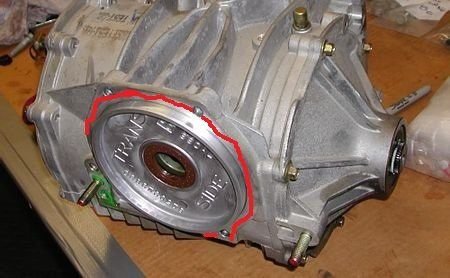

Did you remove the diff seal plate from your auto diff and put it on the 3.42 diff before you did the install?
A4 requires the diff plate. The MN6/M12 does not. So the Z06 doner diff needs your old plate on it before you install it.
If you did that already I'm out of ideas. My A4 knowledge is bubkis.

This (sourced picture from a previous thread by Autoeng)

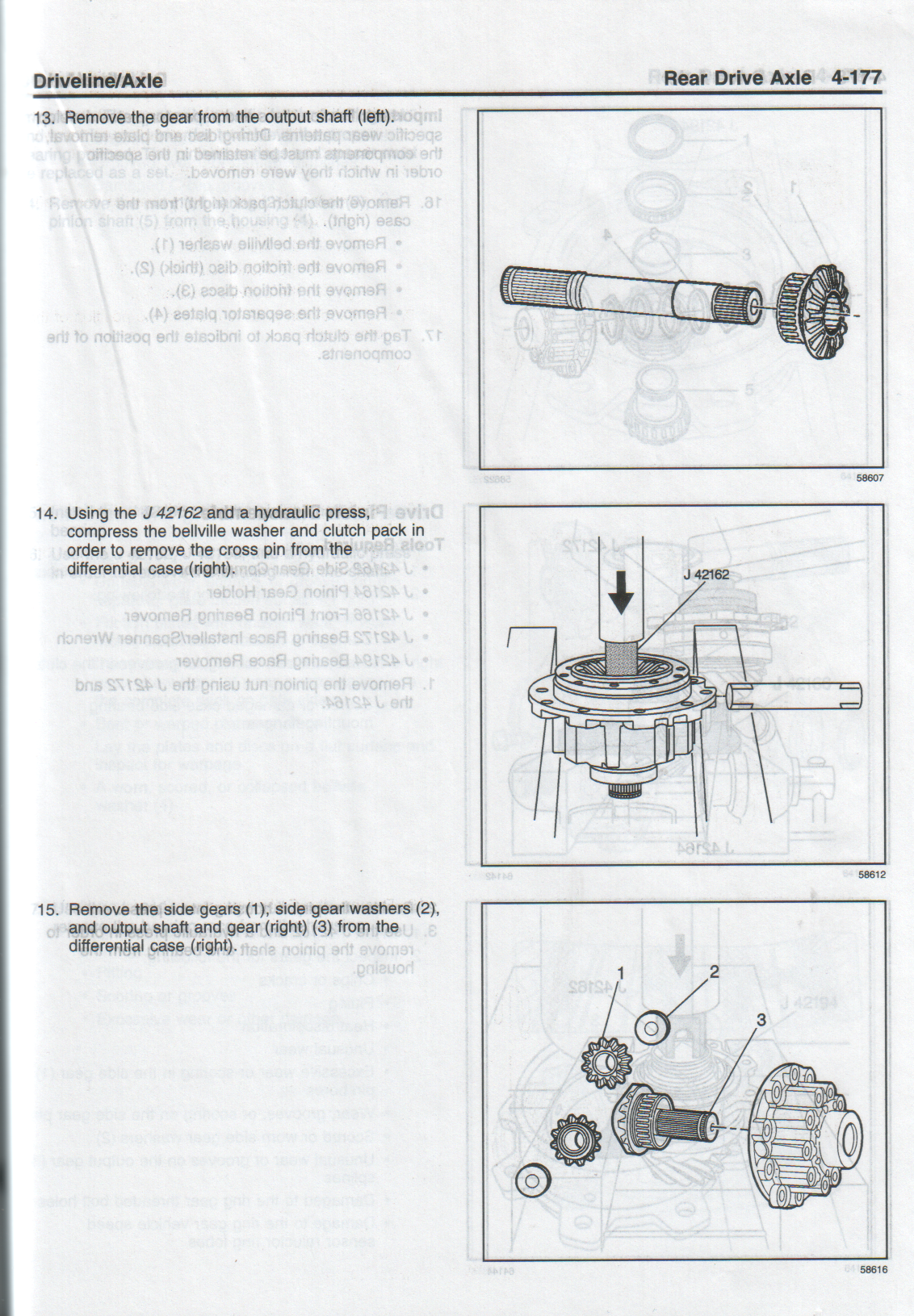

The only way you'd have no movement is if the spider gears (called side gears in the fsm) were missing / broken. Part(s) 1 in illustration 15.

Very first post:
Originally Posted by Wipplash101
When I putit back into park, I heard the park fork in the trans go click-click-click. Which tells me the trans is working fine.
He says he tore it down, so I would think a broken output shaft or spider gear would be fairly obvious. However, it's entirely possible to assemble the carrier with one or no spider gears and have no movement. I figured it's possible if he doesn't have a FSM and know what parts should be in it...
Though the OP didn't specify that it moved prior to the diff swap, another possibility is the trans output shaft is broken or the rear planetary splines are completely wiped out.
