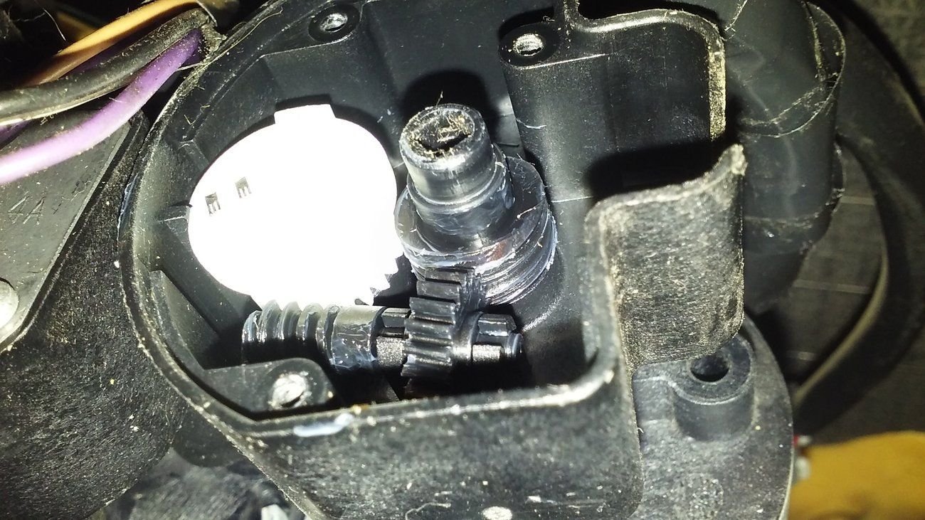

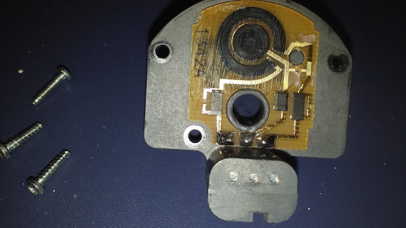

Seat memory is dependent on clean, good contacts in the memory part of the seat motor. First try running the seat all the way back and forth a number of times--this sometimes cleans the contacts enough for function to return. But sometimes only for a short time.
The more permanent fix is to remove the seat, disassemble the motor and physically clean the memory contacts and re grease with dielectric grease..
