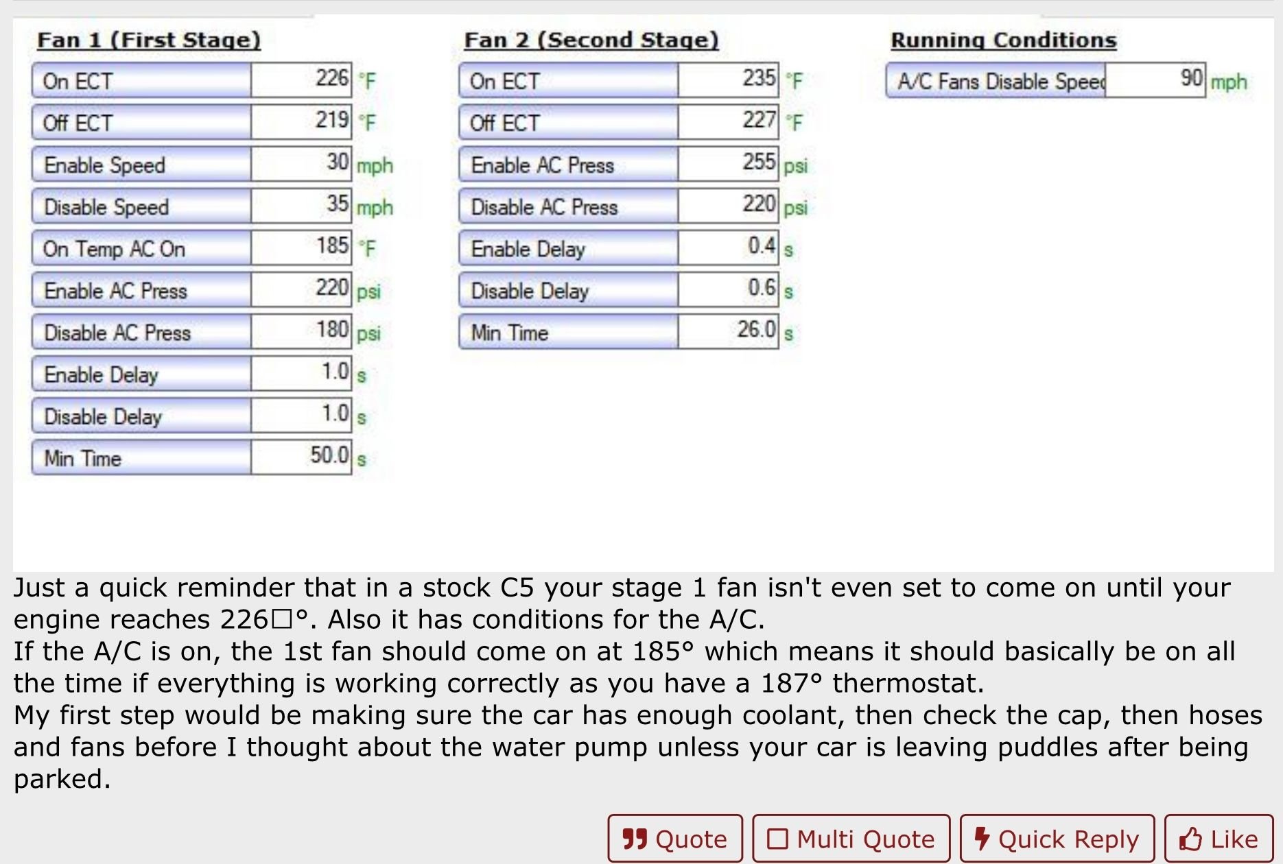

Here’s some reference material on the fans

So I replaced all cooling fan relays to no avail. Both fans continue to work as expected (w/high speed now) but the car rocketed to 240 idle with A/C on before I intervened.
Moving along 30mph+ temps are normal but as soon as I stop it went straight up
