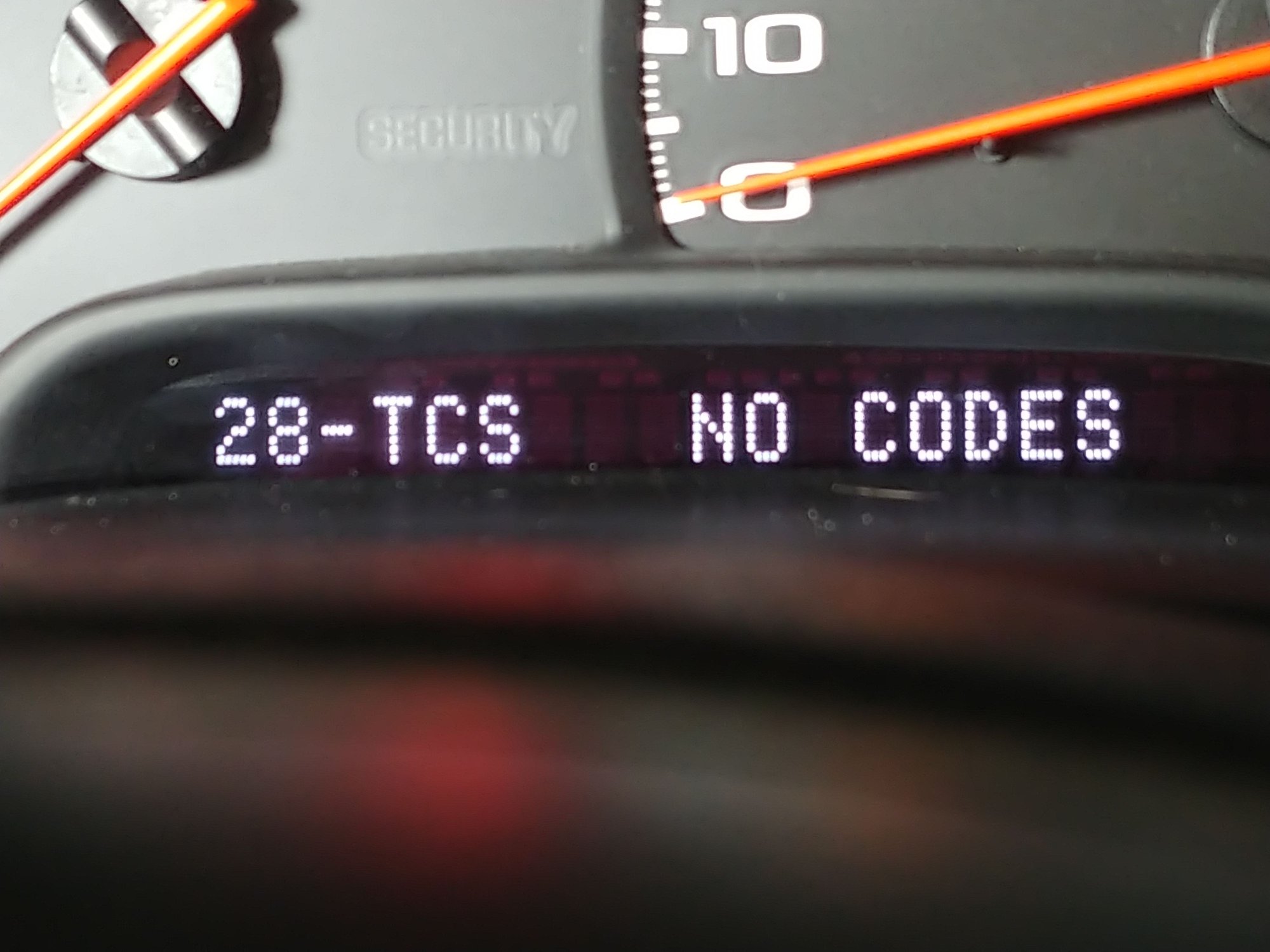

Default Repaired and Working Again
I reinstalled the ECBM, and then went for a test ride.
The warning lights at every start-up are now gone. I was also able to clear the C1214 code after installing the new relay.
Thanks to all who responded!
