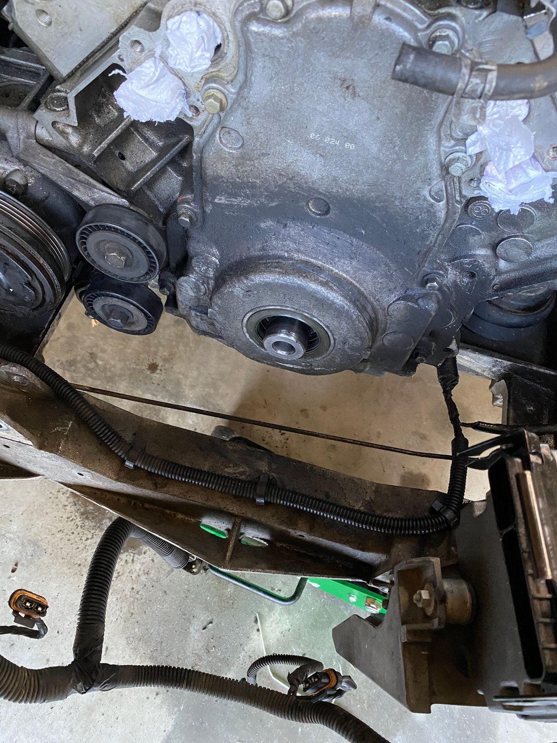

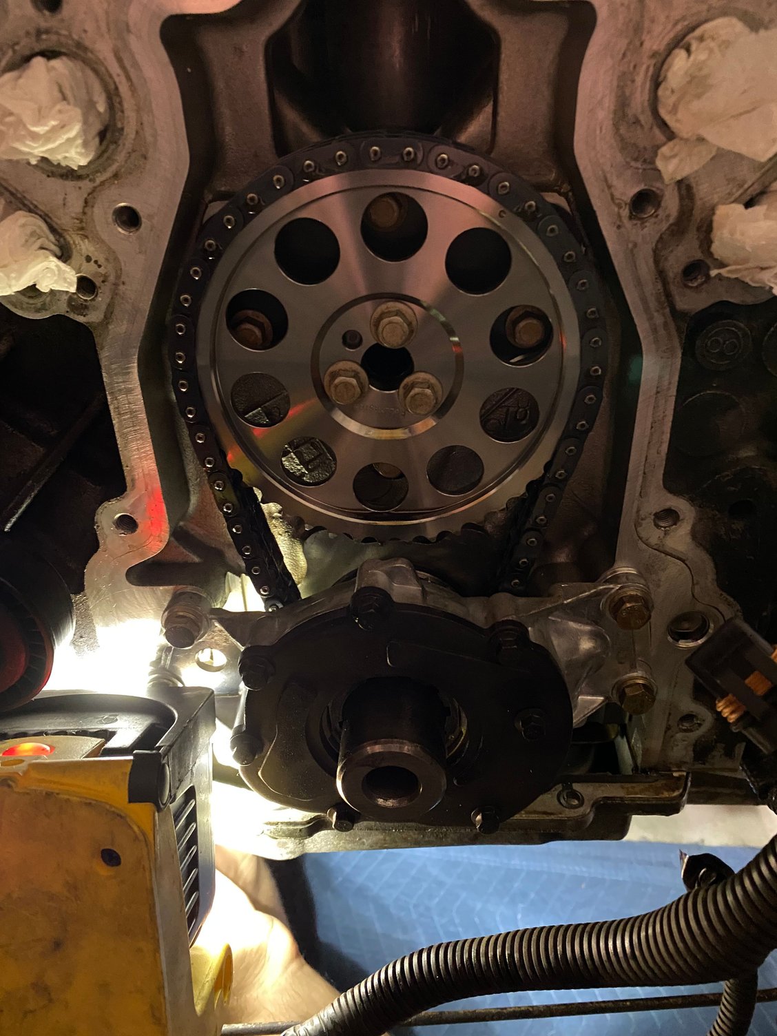

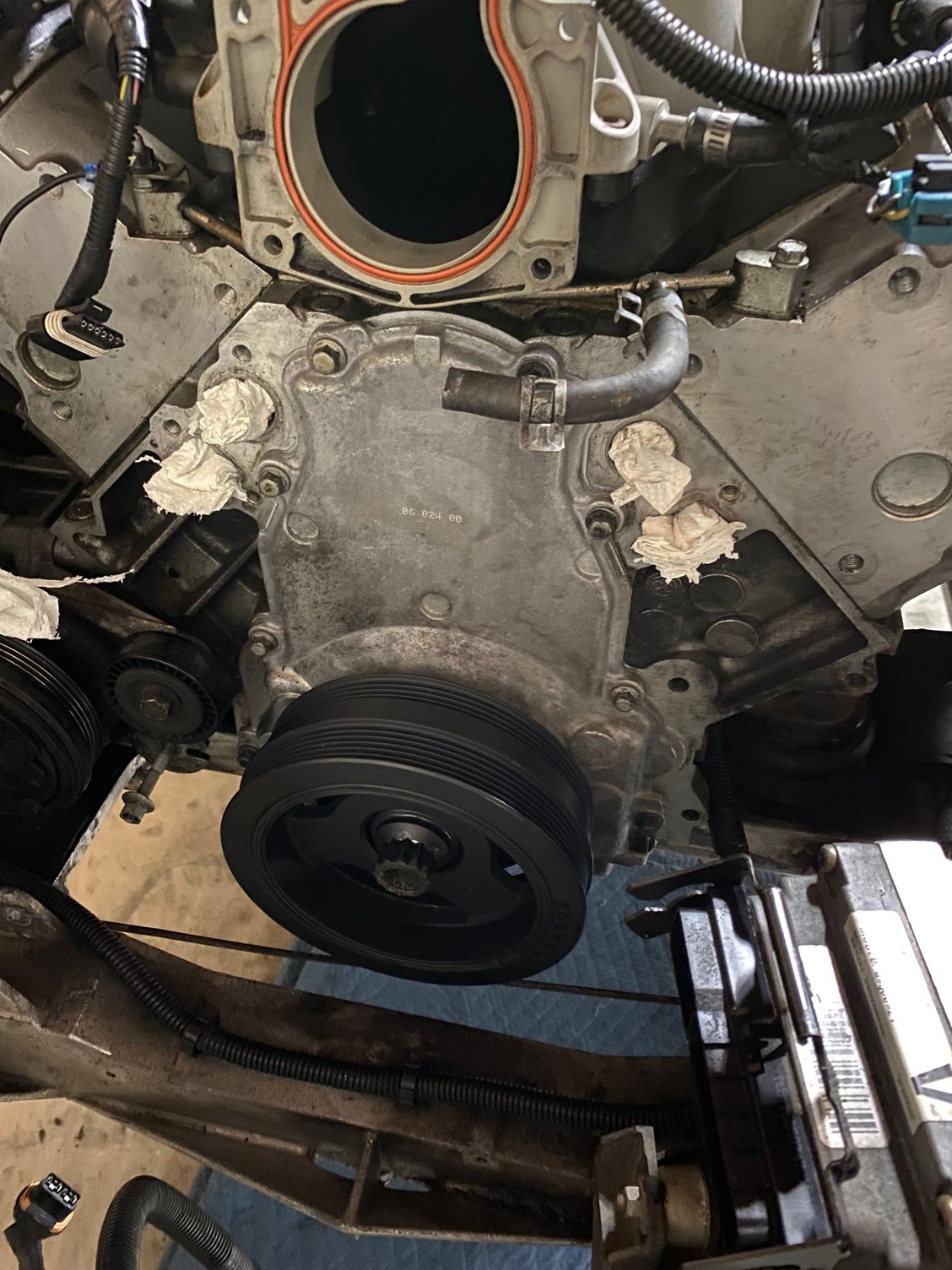

This is 100% factual. CAN you do this by just moving the rack forward, yes. Do you want to do this like that, I sure as hell did not. Of course I was replacing the rack anyway which lead me to do the HB, then the AC, and the oil pump...wow the list is long.
I removed:
Hood
Radiator/fans
Steering rack
Water pump
Alternator/PS pump and bracket
Throttle body
R&R on the steering rack is so much easier with the alternator and water pump and radiator out of the way!

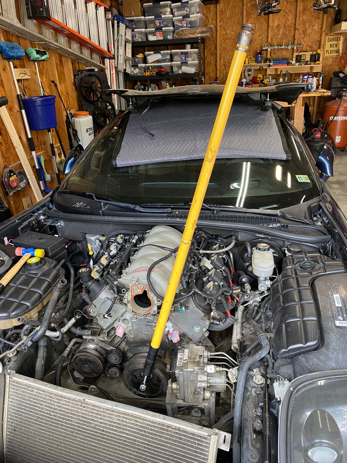

I started with a 1/2" impact running on a small 30 gallon 6.5 hp compressor. The bolt laughed at it. I chronicled my removal https://www.corvetteforum.com/forums...t-s-tight.html because it was amusing and because I genuinely wanted others input (but mostly it was amusing).
We did discover some type of thread locker on the last 1" of the bolt one we got it out. Also, while 5' pipe on a breaker bar eventually removed the bolt, I do believe a Snap-On 1/2" impact broke most of the thread locker loose prior to putting the bar back on it.
@grinder11 I did not use a factory bolt or HB, I went ARP bolt.
It's good you went with the ARP. A 6.5hp, 30 gallon tank compressor should have no issues at all supplying enough air AND pressure. What you need is a better impact. If someone wants to pay $850-$900 for this job, it's their business. But $850 would buy an impact, and probably a good enough air compressor, that would twist that bolt out GUARANTEED!! I thought this thread was geared more towards removing the bolt, not having issues with the rest of the job, as some have posted. Many people have had to replace only the balancer, due to the problems with OEM units wobbling/separating. The radiator and A/C condenser only need removing for a cam change. If it becomes a "while you're in there" situation, their removal is no more difficult than any other car.
