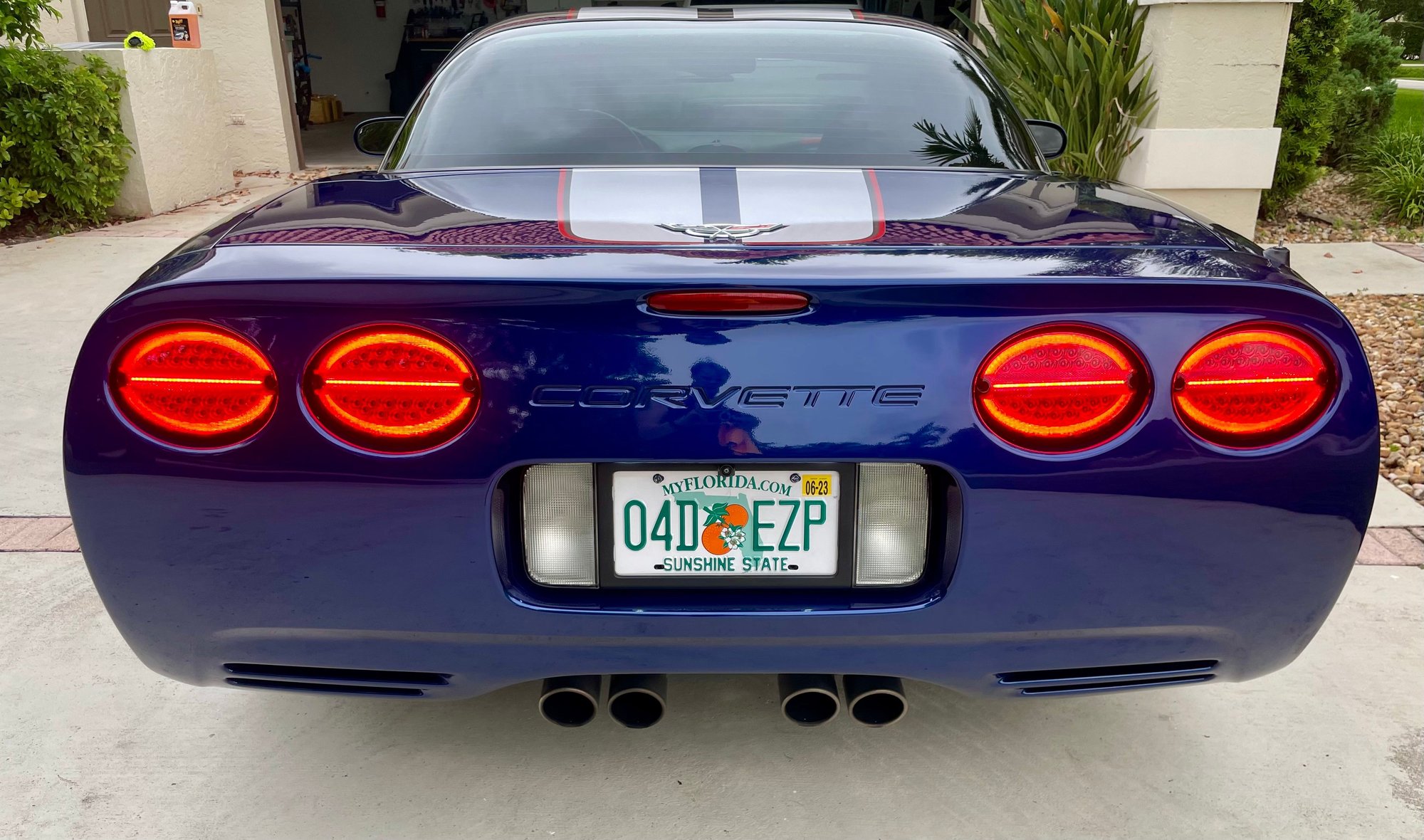

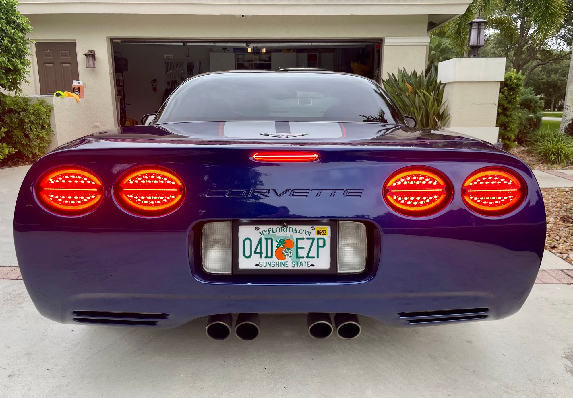

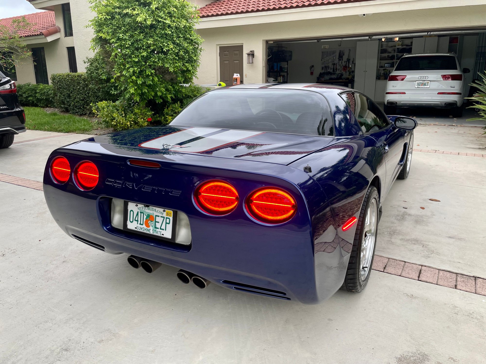

I certainly appreciate both Don and Cole working this through!
I flipped the switch to disable the strobe on the third brake light and no more 1295. It really was that simple!
I no longer get 1295 at all even with the hazards + brakes applied.
I have (all from VetteLights):
  1. Laser LED tails
  2. Laser LED markers
  3. Laser LED third brake (strobe off)
  4. Laser LED front corner assemblies
I absolutely love the look, and couldn’t be happier. The car is in for some radiator and condenser cleaning, but I’ll take pics later this week.
Thanks again guys!
Eric

Default All LED, no resistors, no 1295
