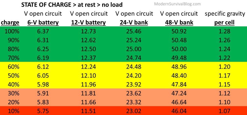

Battery voltage must be measured across the battery terminals to be accurate. Below 12.6 can cause trouble on a C5.
If the battery LOAD tests good, a failing ignition switch often generates all the warnings you describe but does not necessarily throw codes.
