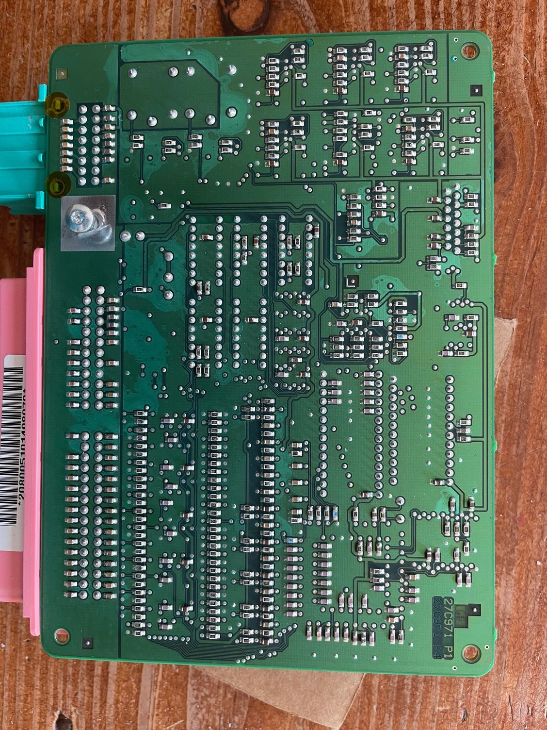

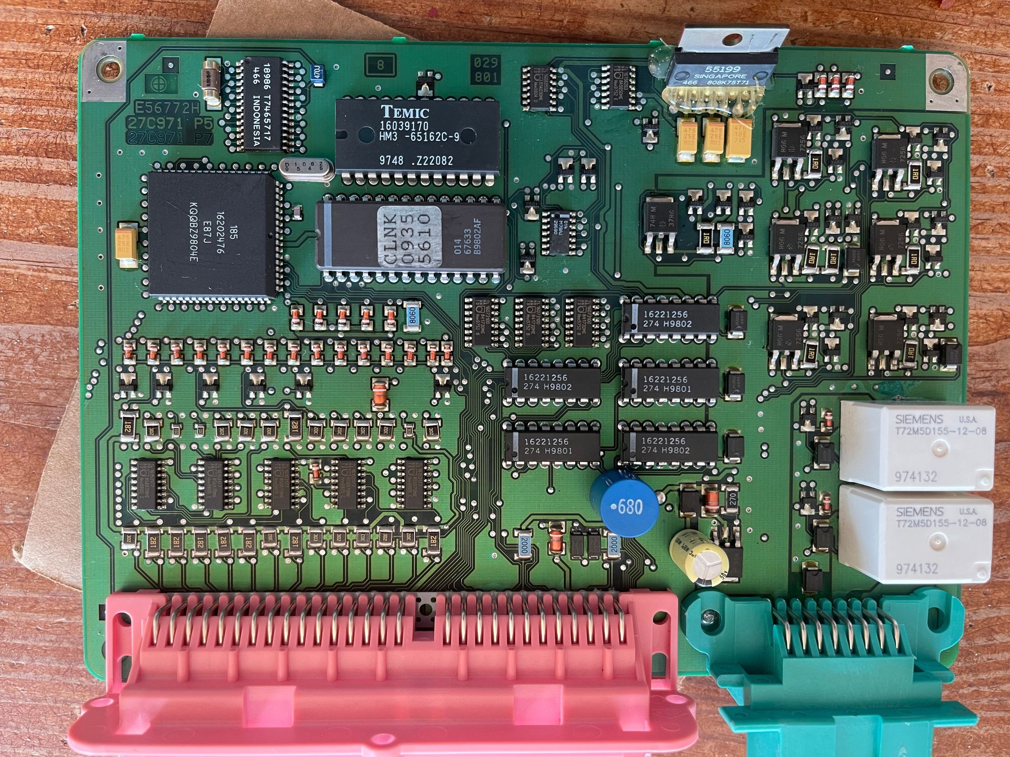

Default Bcm
This is the board
it will start in the evening when it gets hot but this morning nothing
too the board out a let it dry a few days
Think it’s a goner?

From: Espanola New Mexico
Is there any visible corrosion on the board? There are several rebuilders of BCM's one them is G7 Computers heard very good things about them. If you buy another BCM you will have to do a relearn procedure, or maybe it will start working. Did you look at the connectors inside the rubber accordion they could be the cause of your cars no crank as well.
I cleaned it with alcohol and didn’t see any.
