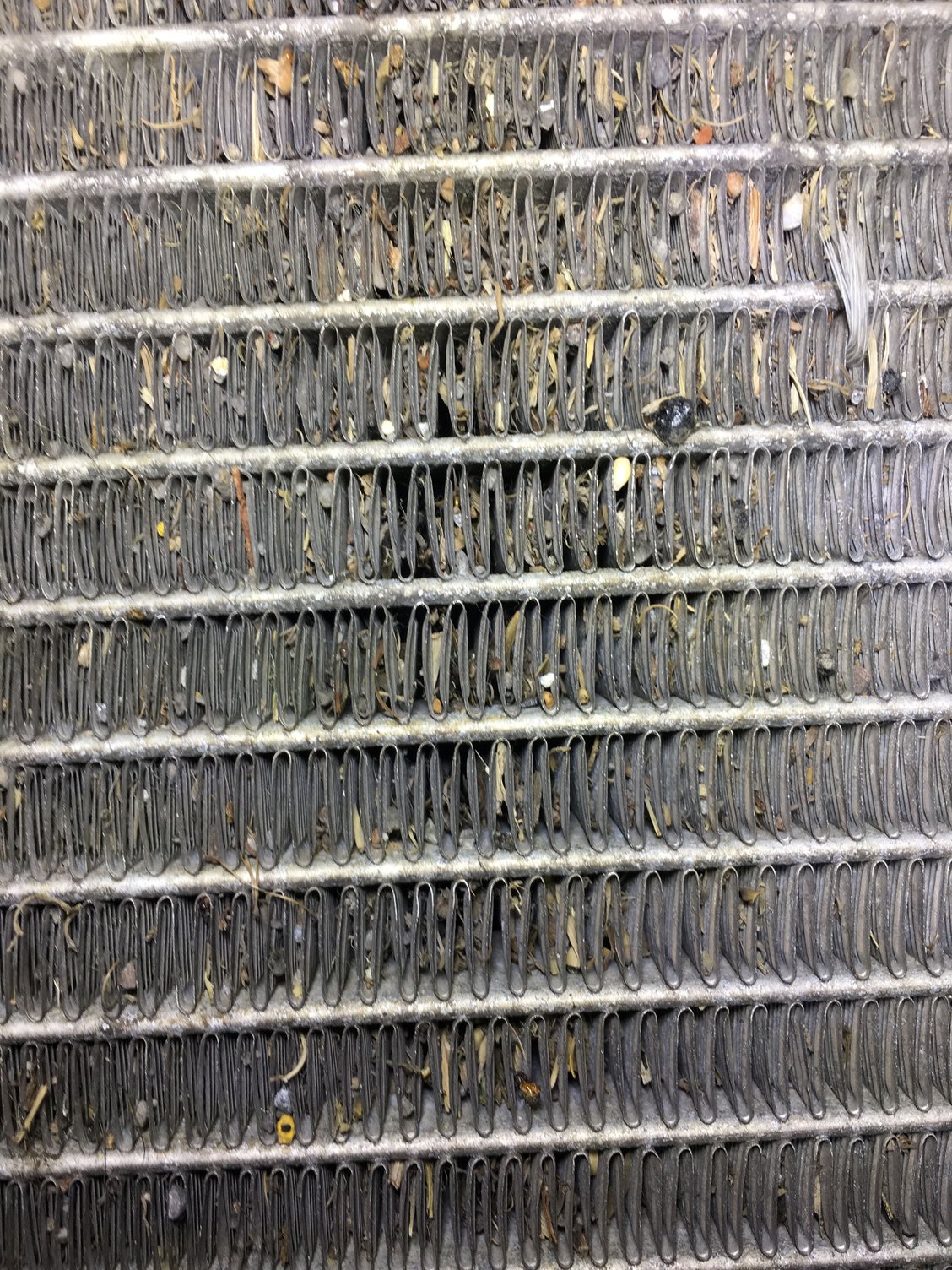

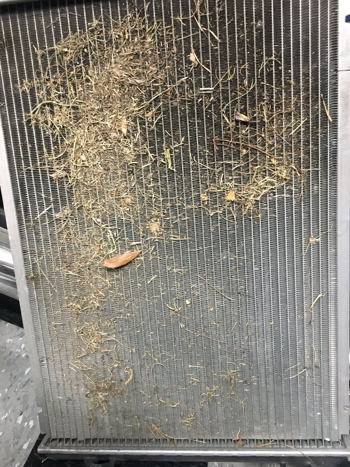

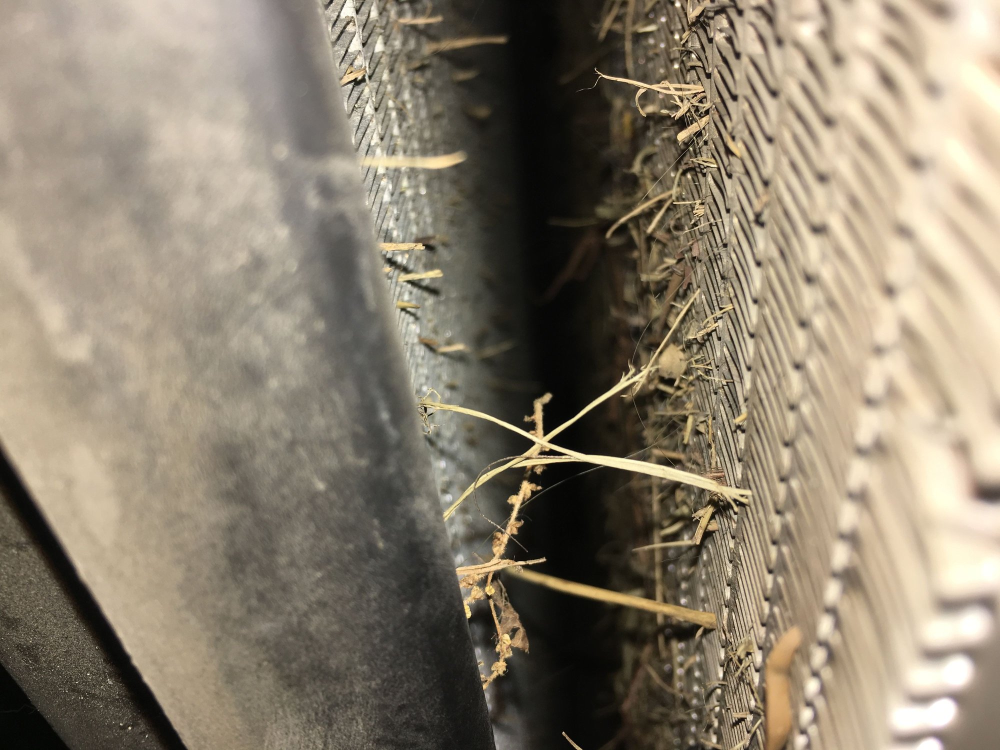

While there are several potential problems when diagnosing overheating in a C5, I want to toss in my experience. YMMV. My 2003 wasn't so much overheating, but the engine temp was just all over the place, which I was uncomfortable with. I checked the usual things, including changing out to new antifreeze. One quick point here is that Dexcool is not compatible with some other types of antifreeze. Some people hate Dexcool, and I understand, but if you are not using Dexcool, you should flush all the old Dexcool out prior to changing to a different type antifreeze to be safe. Read about it. So when I checked for debris buildup, the first picture is the front of the condenser prior to cleaning. The second photo shows the area between the radiator and condenser. The third photo shows the front of the condenser after cleaning attempts. To get to the point, cleaning the radiator to improve cooling is not necessarily as easy as just blowing compressed air (carefully) or just back-flushing with a water hose. Especially look at the pic of the area between the radiator and condenser. Don't trust that back-flushing water through the radiator to clean the condenser is going to be very effective. Air has to go through the condenser to get to the radiator, so I'm going to stretch and say if you haven't removed the cover and back-flushed both the radiator and condenser seperately, you may still have debris blocking the air flow. Maybe if one cleans very frequently, this could maintain air flow, but once you get imbedded debris, back-flushing may not be as effective as you think. In my case, once I determined that debris was going to be difficult if not impossible to remove, I cut my losses and replaced both the condenser and radiator. I did go with a DeWitts radiator, and I am happy with that. I have rock solid cooling, but my problem was ultimately imbedded debris I was unable to clean out. One more bit of advice is that routine cleaning should occur more often in areas you live that may have more debris on the road. In my case, a rural area where minimal traffic may allow more debris to settle on a road, requires more frequent checking and cleaning. When I pass by a place where someone has just cut their grass and there are clippings in the road, I try to avoid it, and if I can't, I know I have to check the system when I get back home.
Condenser prior to cleaning attempts.
Between condenser and radiator.
View through front of condenser after cleaning attempts.

Damn, that's nasty doesn't surprise as C5 Corvettes are bottom feeders and they hoover up all the crap on the road
Thanks for the great pics!!! Perfect example of a radiator/condenser in desperate need of a good cleaning.......
