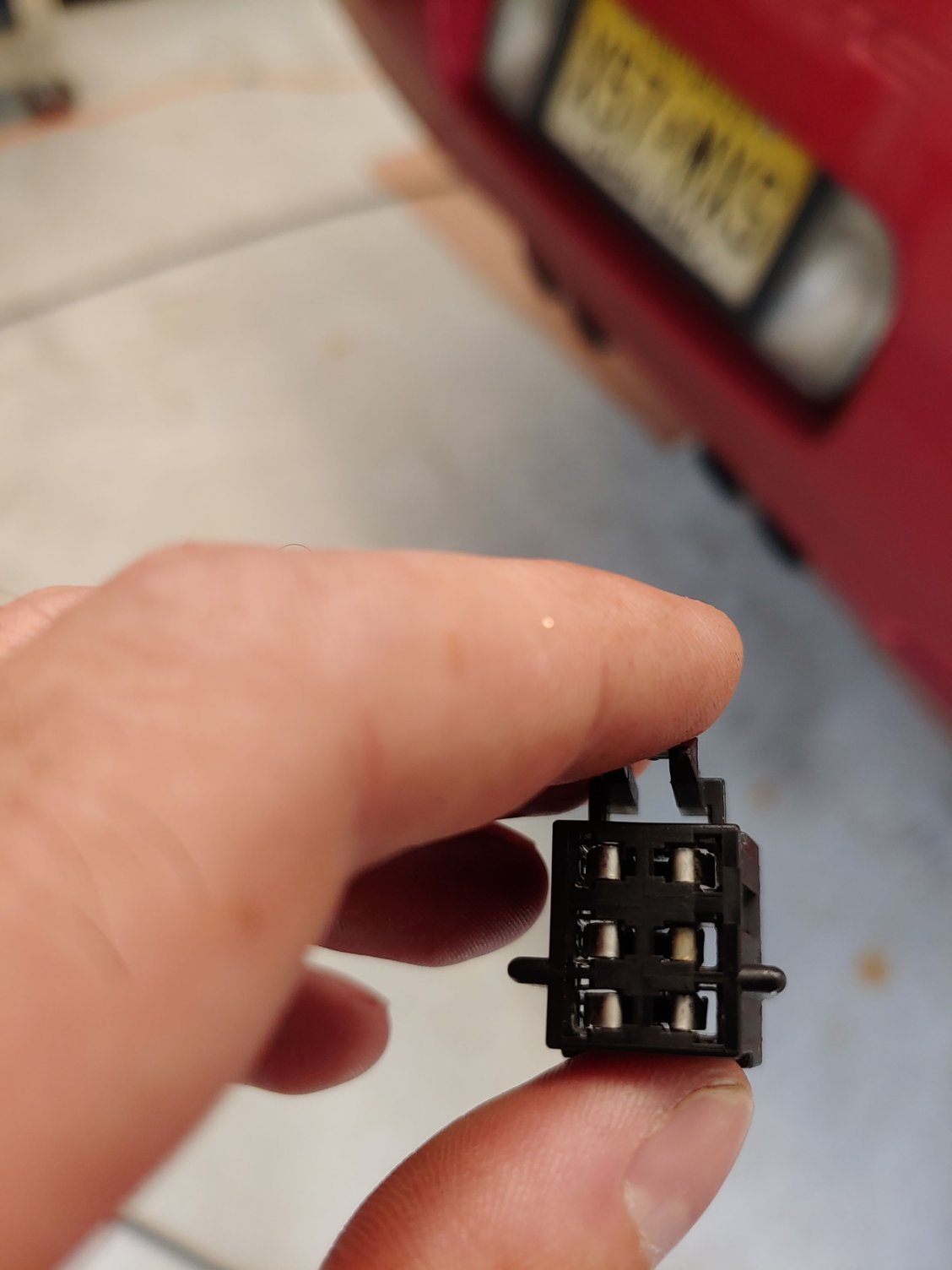

I would check the black electrical connector in the door accordion for terminals that are loose. You can bend them back into shape or try to replace. I had the same problem. It's very common.

You have a bunch of “U” communication DTC’s there…with these you may have a no start or start and stall, power windows not working, you’ll see a bunch of messages scrolling through on the DIC…when you notice this craziness going on shake the “rubber boot” you see when you open up the driver door…may be a bad power or ground on the driver door module…this may happen on any of the cars modules but seen frequently on the DDM.

I get the same thing every now and then with my window and have to open up the door to jiggle accordion boot to get it to work again. I have CEL for known issues but many still pop up as H codes even though I've never had issues with problems listed
