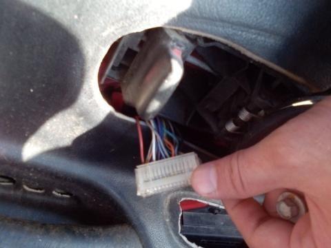

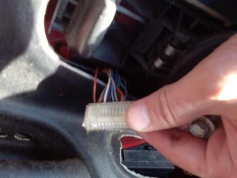

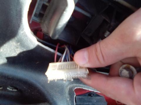

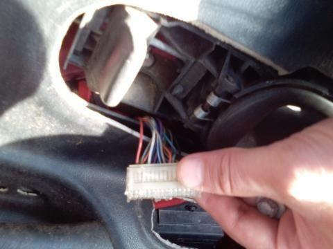

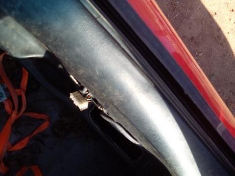

The main question is which wires do i suppky 12 volts to at the master switch to power the windows up as the parts car has no key so i cant power the battery on, i have a 12 volt probe meter i can supply power if anyone know which 2 wires is ground and 12 volts up and 12 volts down to roll the window up to prevent any water getting into the car. Bought the parts car with the drivers side window down and no engine. I can remove the door panel if necessary the previous owner only needed the engine and already removed the door handle trim and switch which is still in the car just dont have the key to battery power key on. I can remove the door panel if necessary to power the window motor switch which should have less wires.

Ok got the window up i found the two wires to the window motor were the larger dark blue and brown wires they were on the lower portion two piece plug connector of the door control module. Just unplugged the two piece connector and supplied 12 volts and grounded the other the window went right up.
