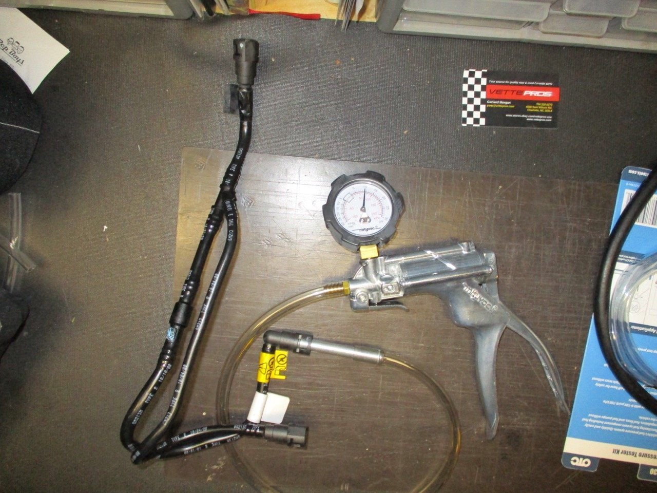

Well, you have two ways to approach this...shot gun a bunch of parts or try to diagnose it and only change one part...if you want to change parts it can be an injector, fuel pump, supply line check valve...you have already changed the fuel filter/pressure regulator and purge valve but new parts can be defective...I have this special tooling from Kent Moore who is GM's tooling supplier but you can make this yourself to diagnose the injectors, fuel pump, and filter...all you need is some rubber fuel line hose, a shutoff valve and a male and female fuel line adapters...to diagnose the check valve you'd need a Mityvac pressure/vacuum gauge with a fuel line adapter...pics below.

You need to attach the Mityvac (pressure setting) to the fuel inlet line at the fuel rail that goes back to the pump (male fitting) and apply 15 psi…the pressure should hold for one minute…if it leaks down the one way check valve is leaking…you will need the 3/8 inch fitting which you can purchase from Amazon.

I guess you can also connect the Mityvac to the fuel rail and apply pressure on that end…if the pressure drops an injector is leaking.
