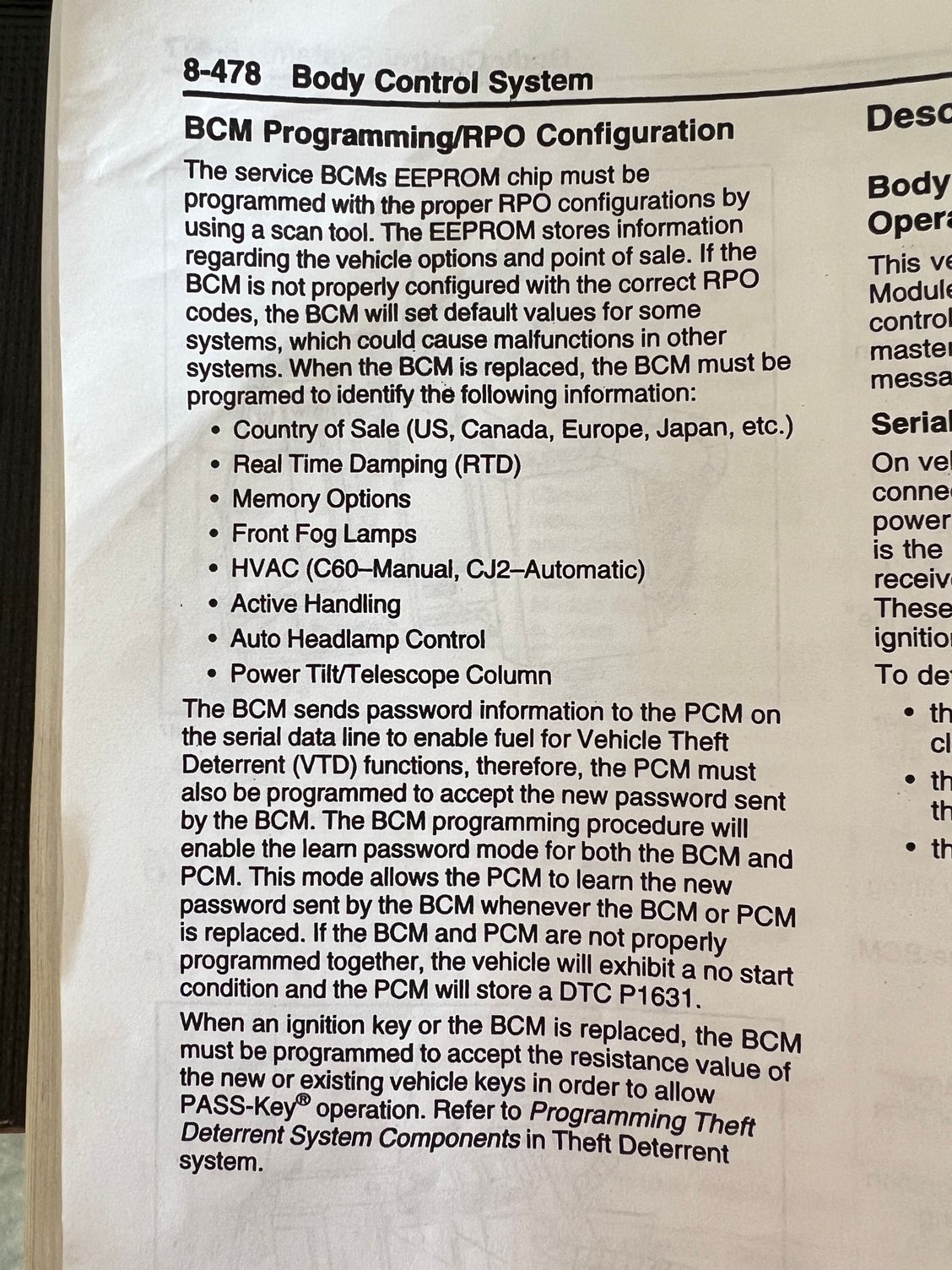

Originally Posted by digmyvette
I did pull the BCM and checked for water intrusion but it was dry. I'll check the purple wire for voltage later this week, if it stops raining and post findings! 🌧 gotta love South Florida
Was the BCM programmed and “configured” (RPO codes) after installation ??…it’s not plug and play !!...check for DTC's...this may also be a comm issue.
