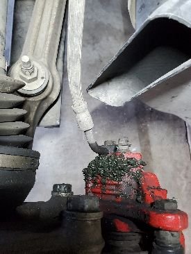

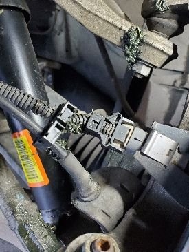

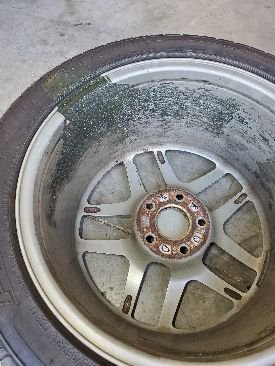

I cleaned my car recently and ruined a wheel brush with grease. When I put things back together I noticed a glob on the E-Brake / ABS wire. Wiped it off, didn't think much of it. Today,luckily, I noticed a HUGE amount on the Barrel of the wheel. Took it off and found all this. There is A LOT of grease. Do y'all think it's from the CV Joint? It only spewed it in one area - a big blob. There is no apparent cut / slice in the boot. It is actually in nice shape.
I have no clue. It's pretty clean now - I will drive it and see if more shows up.
Thanks for any help!!

The location and spray pattern definitely coincides with grease ejection from the outer CV boot. Time to pull the axle, not too bad of a DIY job.

The greenish tint is a big tell. Probably a hole in the CV boot.

Ahhh that's most unfortunate. With all that grease loss plus future (expected) grease loss, the outer CV joint may become starved for grease and start wearing excessively.
Swapping an axle ought to be pretty quick, if you have time in the midst of your trip preparations. See if a local Autozone has an axle in-stock for a quick swap: https://www.autozone.com/drivetrain/...03n/401572_0_0 My local Autozone coincidentally has this in-stock. Also, my '01 Z06 has been running a Duralast axle for the last 5k miles and almost 2 years... so far so good. It was only meant to be temporary until I re-booted my original axle.

Looks like a C/V joint throwing grease to me.
