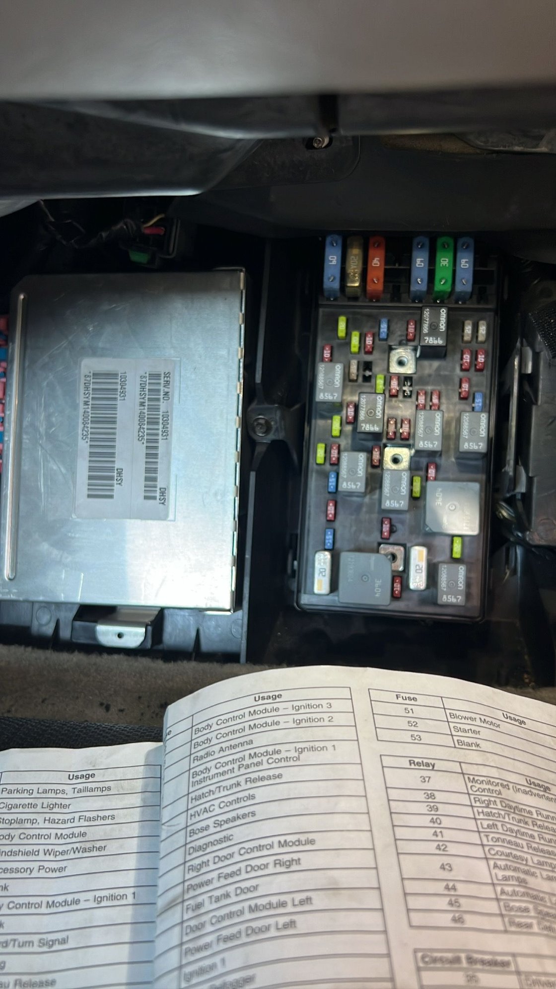

where exactly is that fuse can’t seem to find the ones that are labeled RTD , lol sorry newbie here 😅
Lol! You're in the wrong fuse panel. It's the one under the hood not the passenger kick panel.
#51
it didn’t work on mine , what would you recommend me

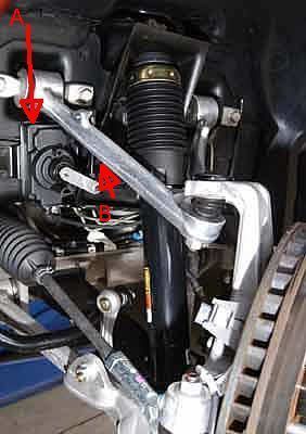

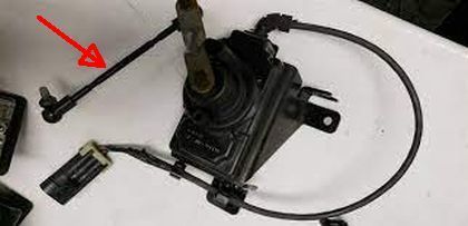

When you look at the A-arm do you still see this little link connected to the A-arm and it's position sensor?
I attached a couple pictures showing what they look like
This is the position sensor and the link
And this position sensor location "A" and "B" shows the link
This is the sensor and "B" is the link
