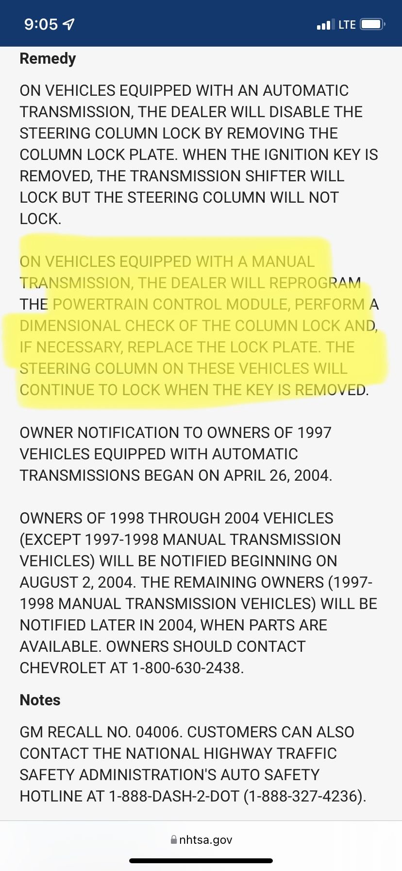

Completely untrue. The "C" version of the recall fixed it permanently by stopping the column locking at all. Mine's been in place for many years now with no issues.
Old Aug 23, 2022 | 10:40 AM
dbgoodwin's Avatar
dbgoodwin
Joined: Feb 2013
Posts: 4,346
Likes: 755
From: Greensboro Nc
just because you haven’t had issues, doesn’t mean that it’s fixed. This is also a manual transmission car, meaning they didn’t remove the lock plate in any of the recalls like they did with yours.
you can still have an issue where you get a “service column lock” and will have fuel cutoff at 2mph with the recalls done, just in your case the column won’t be locked.
Old Aug 23, 2022 | 03:19 PM
jackthelad's Avatar
jackthelad
Joined: Jun 2013
Posts: 3,473
Likes: 691
From: West Virginia
Mine is a manual trans car and they did remove the lock plate for the C recall. You can sit in the car, no key in the lock and wiggle the steering wheel
Dealers are to remove the column lock plate on U.S. and Canadian vehicles equipped with an automatic transmission and U.S. vehicles equipped with a manual transmission. After the service correction, the steering column will no longer lock when the key is removed.
On Canadian and export vehicles equipped with a manual transmission, and export vehicles equipped with an automatic transmission, Dealers are to 1) reprogram the PCM, and 2) verify there is adequate lock plate clearance and, if necessary, replace the lock plate. After the service correction, the steering column will continue to lock when the key is removed.
Refer to the Product Safety Bulletin #04006C for further information.
Like I said, a lot of misinformation around this topic. But hey, someone made money selling unnecessary "fixes".
Not so fast! I am the original owner of my 99 MN6. I've had every recall done including the locking plate removed. Yes, Santa Monica Cheverlot removed the locking plate on my MN6. I still had issues 16 years later with the "pull key" error message. No my steering didn't lock but I still got the error and the car would not drive over 2mph. Not until the LMC5 with brown wire mod.
So if there is "misinformation" it's you spewing it.
he is correct and I was incorrect about the column lock plate not being removed on manual trans cars. I was under the impression that all recalls had been completed on my car (back in 2012 ish) however, my column always still locked. Guess I never dug more, but it’s still widely accepted that there can still be an issue that causes fuel shut off at 2 mph even with the lock plate removed.
this is where I got my info for them not removing the lock plate, from NHTSA. Your document is clearly directly from GM though, so NHTSA must have not updated it.
