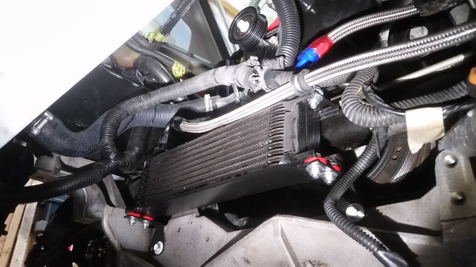

As has been said, if you track you 100% need a power steering fluid cooler. Especially if you have a base C5 - even the factory Z06 cooler is marginal if you're going at any kind of pace. Put one of these in - very easy/necessary upgrade.
