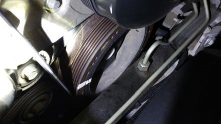

Put the paint marks on the front like this

Ok thanks I’ll do that and if the lines are not across that means I have issues than
If they don't stay straight it is slipping

Marked it today. Thanks
