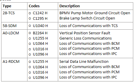

Thanks for your reply. I wouldn't put it past me to forgot to plug that in. I double checked the traction control button connection on the center console panel and it was good. I took out the hyperflash module and everything returned to normal (no codes). I replaced the module and the problems reappeared. I even have a second hyperflash module from Vette Lights (bought two different kits) and it has the same issues. My next call is to Vette Lights to see if they have any ideas. Below are the codes I see when I first install the module.
