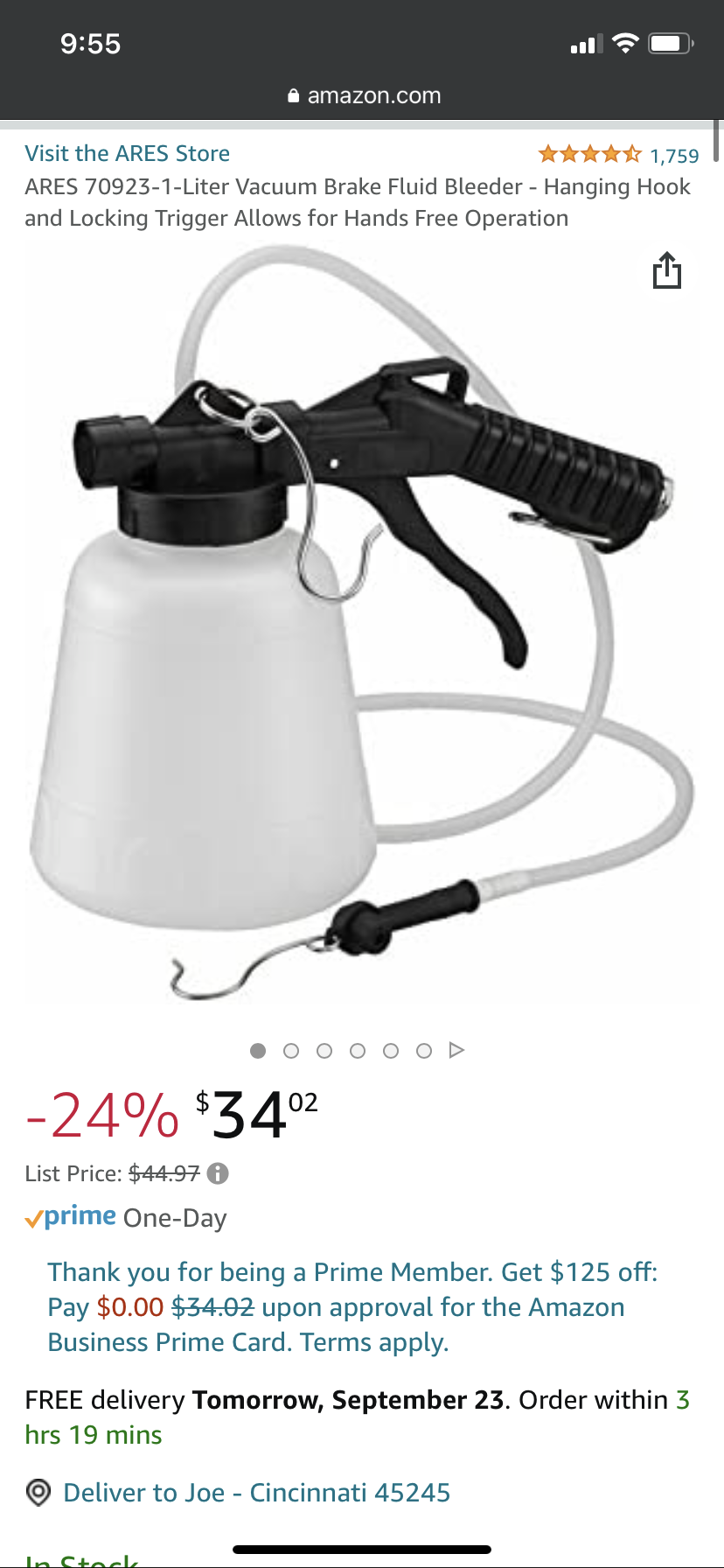

For those of us with remote clutch bleeders, this tool just absolutely amazed me. I’ve had a mityvac for many years and it has its place, but this deal is night and day better for bleeding the clutch. I completely replaced my clutch fluid in less than five minutes while standing still, including putting the air chuck on the tool. I can’t recommend this enough.

I've been told many times how great these things are, but I'm still not sure how they even work. Might have to finally pick one up next time I'm doing this.

You attach an air hose to it and control the suction flow with the trigger. I am going to flush my brake fluid this weekend with it and if it’s as effective at the task I’ll be angry I spent all these years pumping pedals. Highly recommend, even just for easy clutch fluid maintenance

Ok, so you can auction the old fluid out, how does it replace it and bleed it? I'm just not understanding how this works. I need to do a clutch flush.

It attaches to the bleed screw and pulls a vacuum, same as any other vacuum bleeder. I have the Harbor Freight version of this and it came with a bottle that keeps the reservoir topped off. Works really well: https://www.harborfreight.com/brake-...der-92924.html
