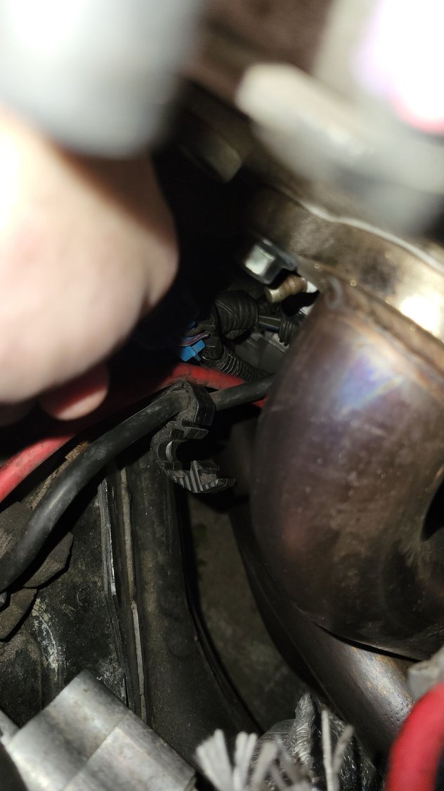

So in my search for a weird issue with the car basically stumbling/cutting off while going down the road I found this connector near the back of the passenger side head zip tied to the ground to the block and the power wire to the starter from the battery. Its a 4 pin connector with what looks like a white, black, grey( could be brown) and a purple with white stripe on it. Can't find the other end of the connector behind the intake and have no idea what it goes to.
Sorry for the crappy pictures its hard to get my paws in there and my phone.

My guess is an O2 sensor connector.

Looks like the O2 sensor plug

Rear O2 sensor. looks like the car has long tubes and ARP head studs so they could have deleted the rear O2s and just turned them off in the tune.
