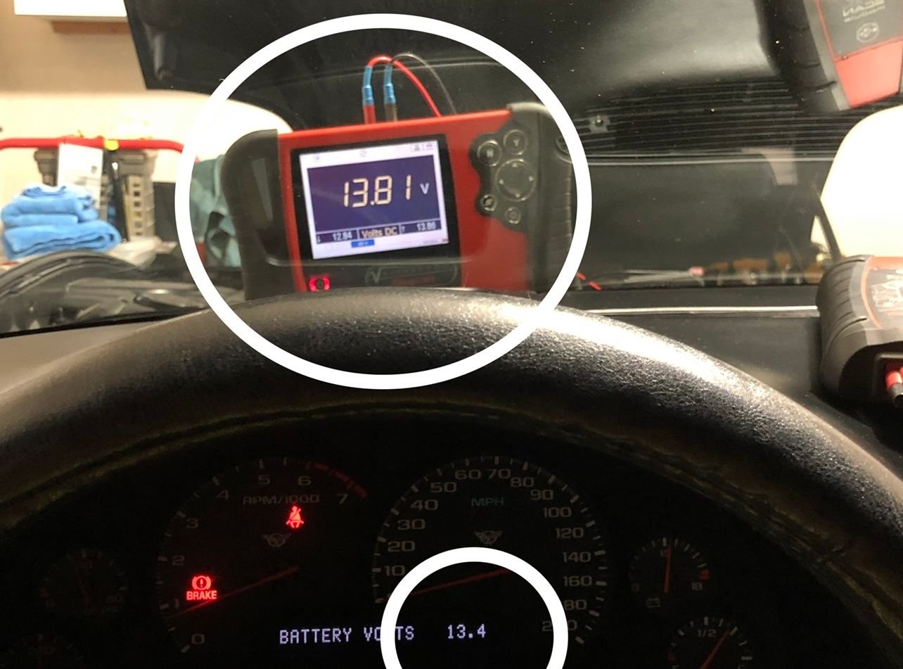

Normally the gauge reads a little lower than actual battery voltage as you can see in the picture.
