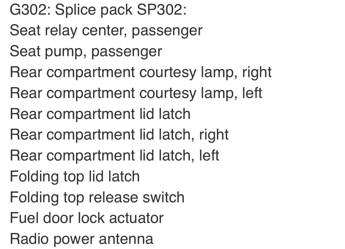

Both circuits go to a splice pack (SP302) and that splice pack is connected to ground…you will have to remove the bus bar off the top of the splice pack and check for bent pins or corrosion…below are the other circuits on that splice pack…are those items inop ??…if they are then the ground itself is bad.

No joy. The passenger seat pump works. The rear compartment lights work. The compartment lid latches work (with the key fob). The fuel door button and the compartment lid button on the dash don't work. I'll pull thee connector and look for bad pins, but everything was working, and I haven't done anything with the connector, so I'm not sure why those two items would stop working. I'm also going to try pulling error codes to see if anything pops up there.
