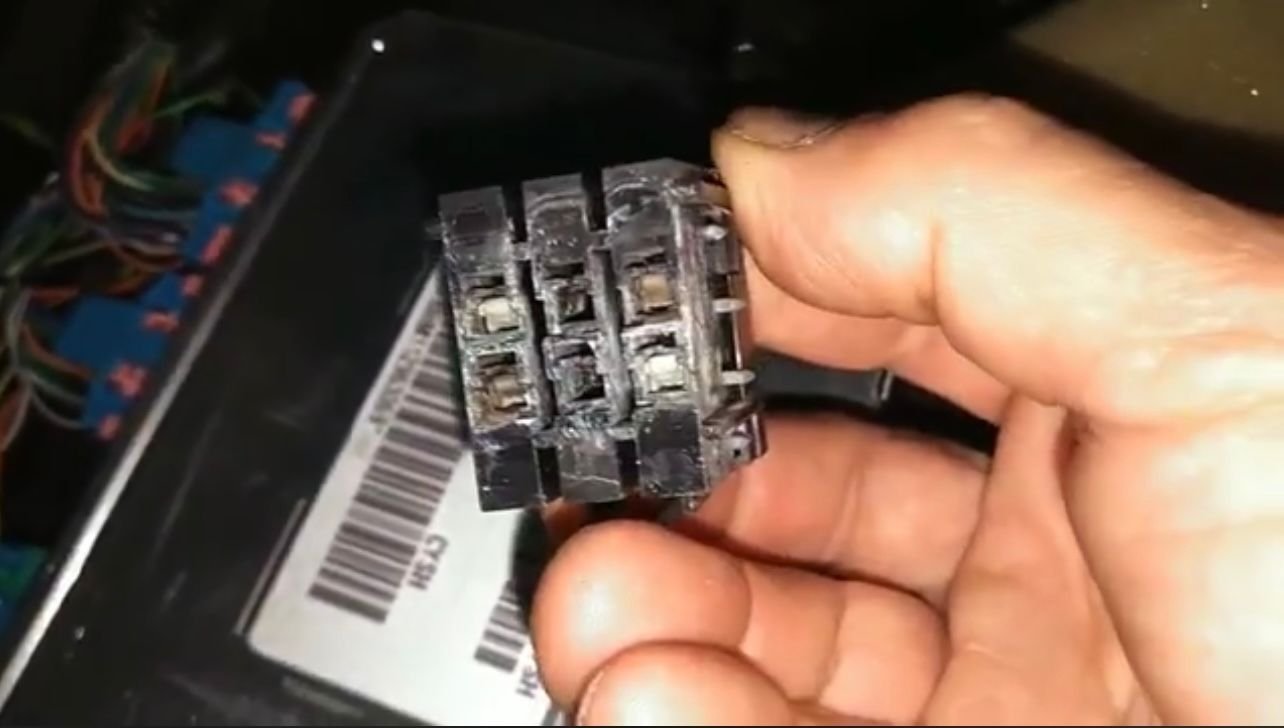

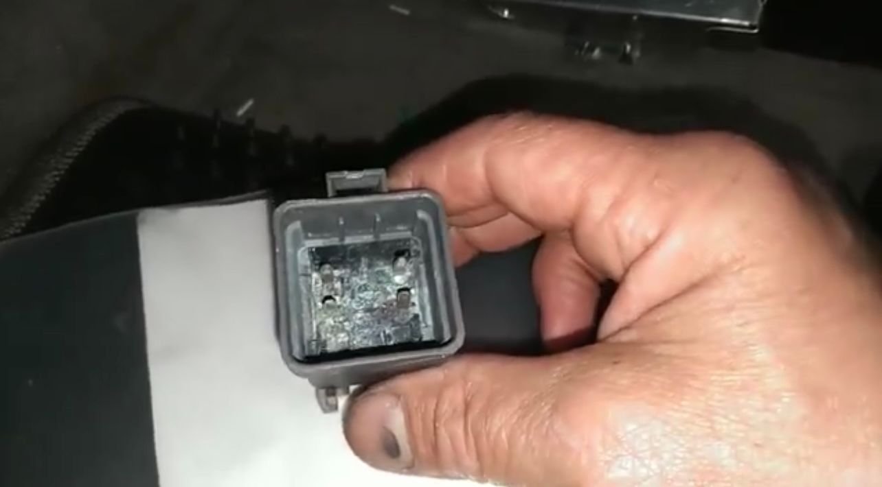

Have you removed and checked the CL Relay above the BCM…you may find some corrosion there.

My car is a 1997, I have researched this in the past and verified that only the TDR sits above the BCM, my column lock relay is located within the BCM.
