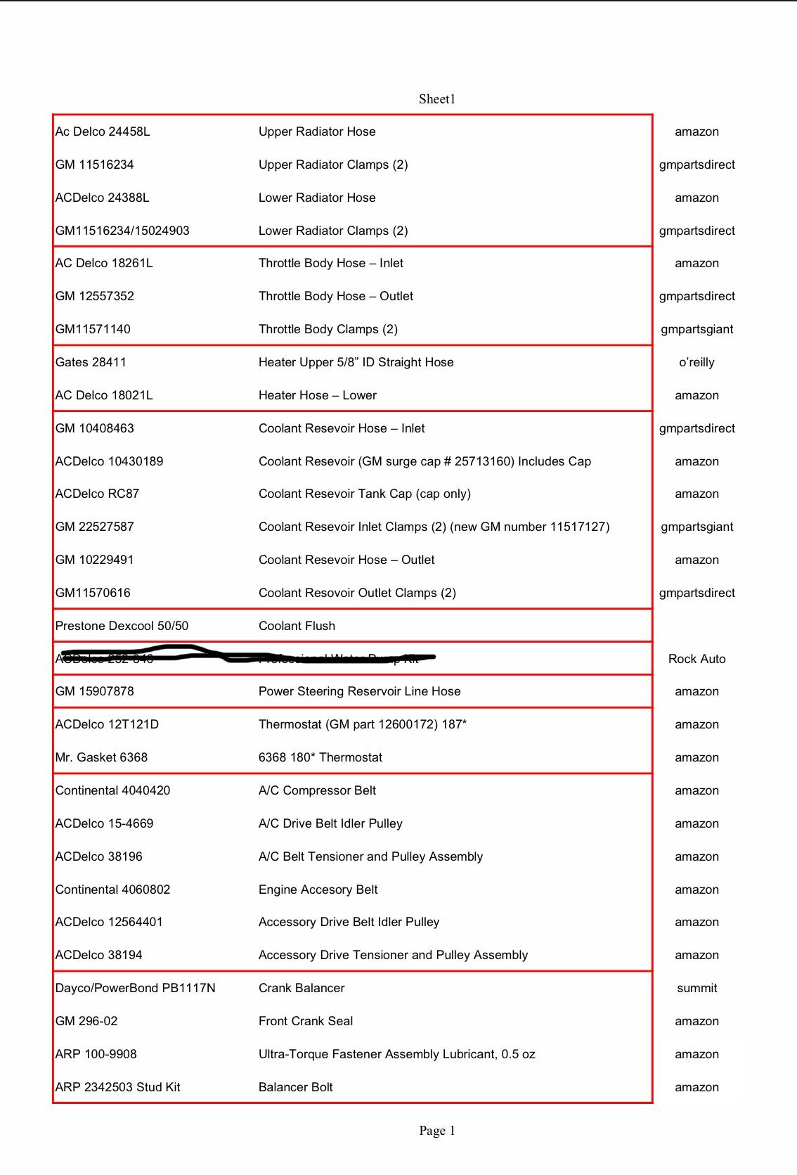

I urge you to avoid leak radiator stop leak. Either a new OEM radiator, or choose from a handful of double row aluminum radiator manufacturers.
Here’s a list of all the coolant parts, aside from the radiator itself, and where to buy them. Frankly, I prefer the factory constant pressure clamps (included in the table); just need the proper pliers. They’re available on Amazon, and not expensive.
