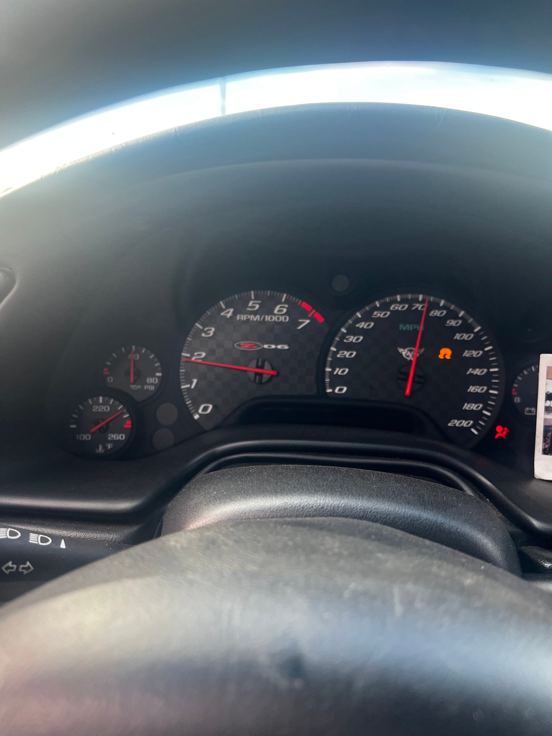

Hey guys recently cammed my 01’ c5 z06 and started having issues with temps on the freeway
I did install a new water pump and a 160° thermostat, fans do spin and I did the burp procedure in case there was any air trapped in the system
Here are some pics of that my temp gauge reads
It’s reached up to 250 before I put the car in neutral and let it roll to cool down
City driving though I get 210-220
I’m stuck on what the problem could be

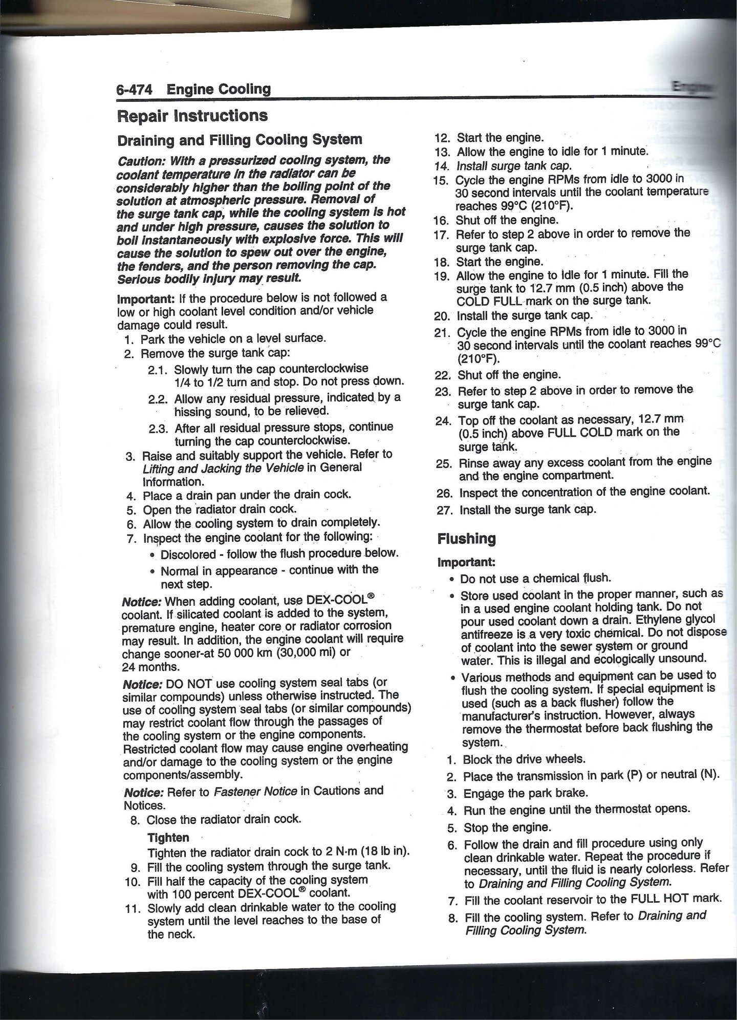

DO the Factory Service Manual procedure to get air out of the heads.

With a cam just being put in, I immediately think bleeding, air dam, was a tune required for the cam that was not done, rag left in the engine? There are a lot of possibilities here. Some simple diagnostics with a temp gun on each side of the t-stat and at hoses will tell a lot. Also, there's a chance the temp sensor is on the way out. Have to keep that possibility in mind and another reason for a 15$ temp gun from Amazon. Would like to see what the digital temp reading is as well.
If the car sits at idle and hits 250, it's obviously not an air dam, it's fluid, fans, obstruction (internal or external).
If it's only when driving on the highway, we are back to air dam, sucked up a bag, dirty fins, rag left in engine. Driving on the highway, fans would not be needed to keep it cool.
