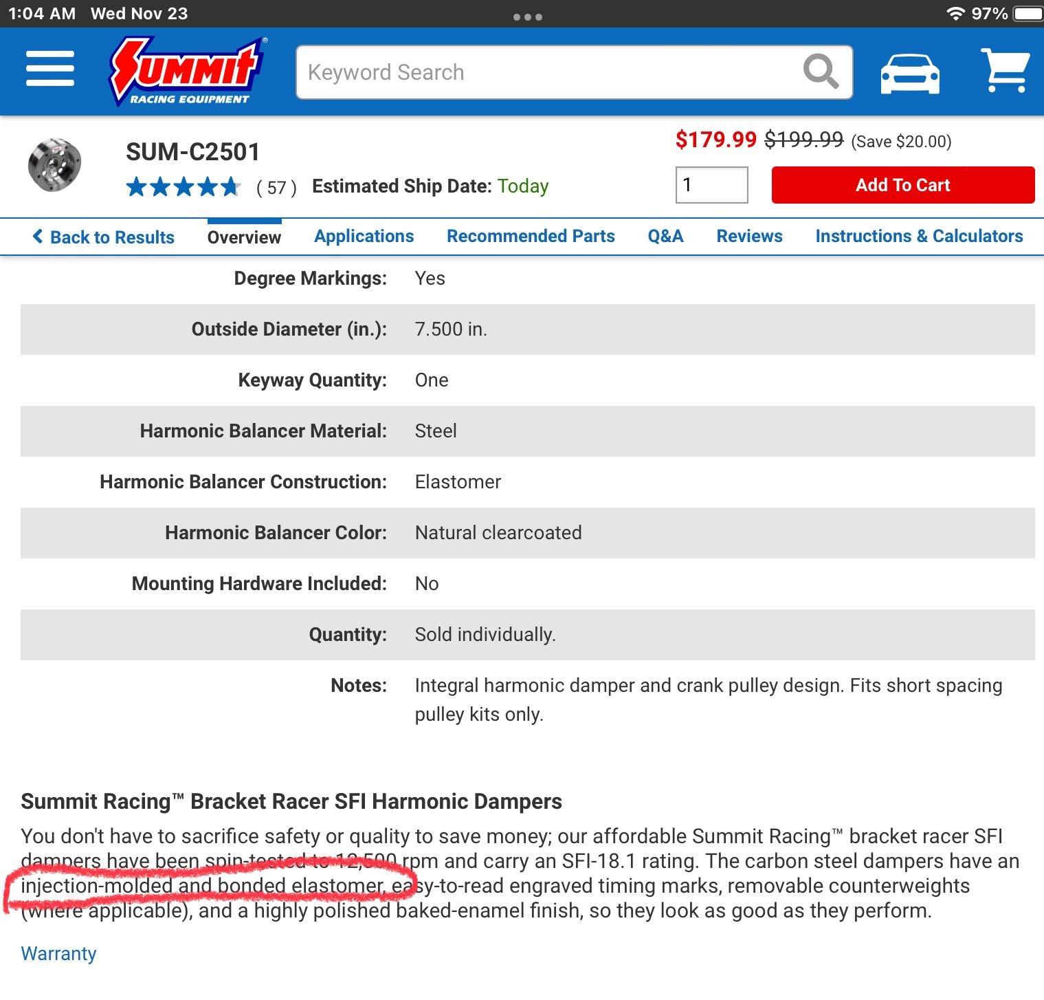

Originally Posted by 2003_Coupe
I thought it was sensless to spend almost $500 on a pulley. Thats all it is. I went with the one piece summit racing balancer. If your not planning on a wider belt just save a substantial amount of cash and get the summit pulley. I have it on my ecs supercharged corvette. It works....exactly like a pulley should.
While it does incorporate a pulley, it’s much more that that. The damper’s major role is to dissipate the harmonics of the crankshaft.
If you check the Summit “harmonic balancer construction”, it will state “elastometer”. Same as OEM type, except not so likely to fail.
Old Nov 23, 2022 | 12:09 AM
2003_Coupe's Avatar
2003_Coupe
Joined: Apr 2020
Posts: 306
Likes: 54
but its not the same. Its a Solid piece of steel. Oem is two parts bonded with rubber, which is its failing point. My post was really to poke fun at the ATI "super damper." I just cant justify that. Its all subjective though.
Harmonic balancers need some method of dissipating the crank vibration. Elastomer, fluid, etc. A solid piece of steel won’t provide that. While the injection molded elastomer is located differently than OEM, it’s still resides within the Summit balancer to stretch and contract between the components. This stretch can be accomplished with a band around the circumference of the pieces, inner-outer rings, or a centrally injected body and shell configuration.
Old Nov 23, 2022 | 09:54 PM
2003_Coupe's Avatar
2003_Coupe
Joined: Apr 2020
Posts: 306
Likes: 54
well i learned something new. I had no idea. It really does seem solid. Thanks for the follow up! It really is a quality piece. Like i said, i would recommend it for anyone staying with a 6rib.
