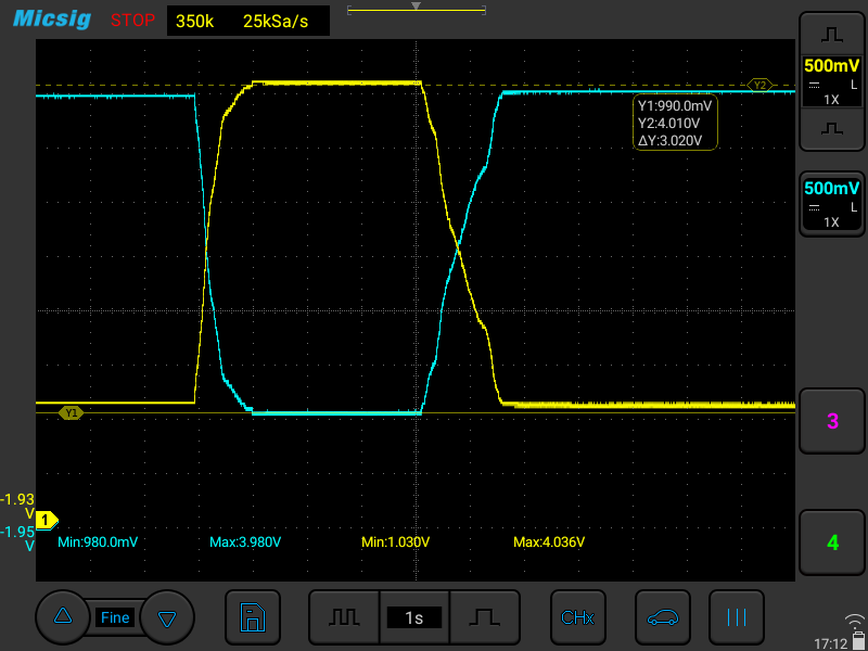

Old Dec 1, 2022 | 02:52 PM
oelarse's Avatar
oelarse
Joined: Jul 2011
Posts: 996
Likes: 306
From: Southern Norway , Europe
The voltages from both tac sensors when backprobing the sensors at the trottlebody should behave like this when you press the pedal to the floor with ignition ON engine OFF
