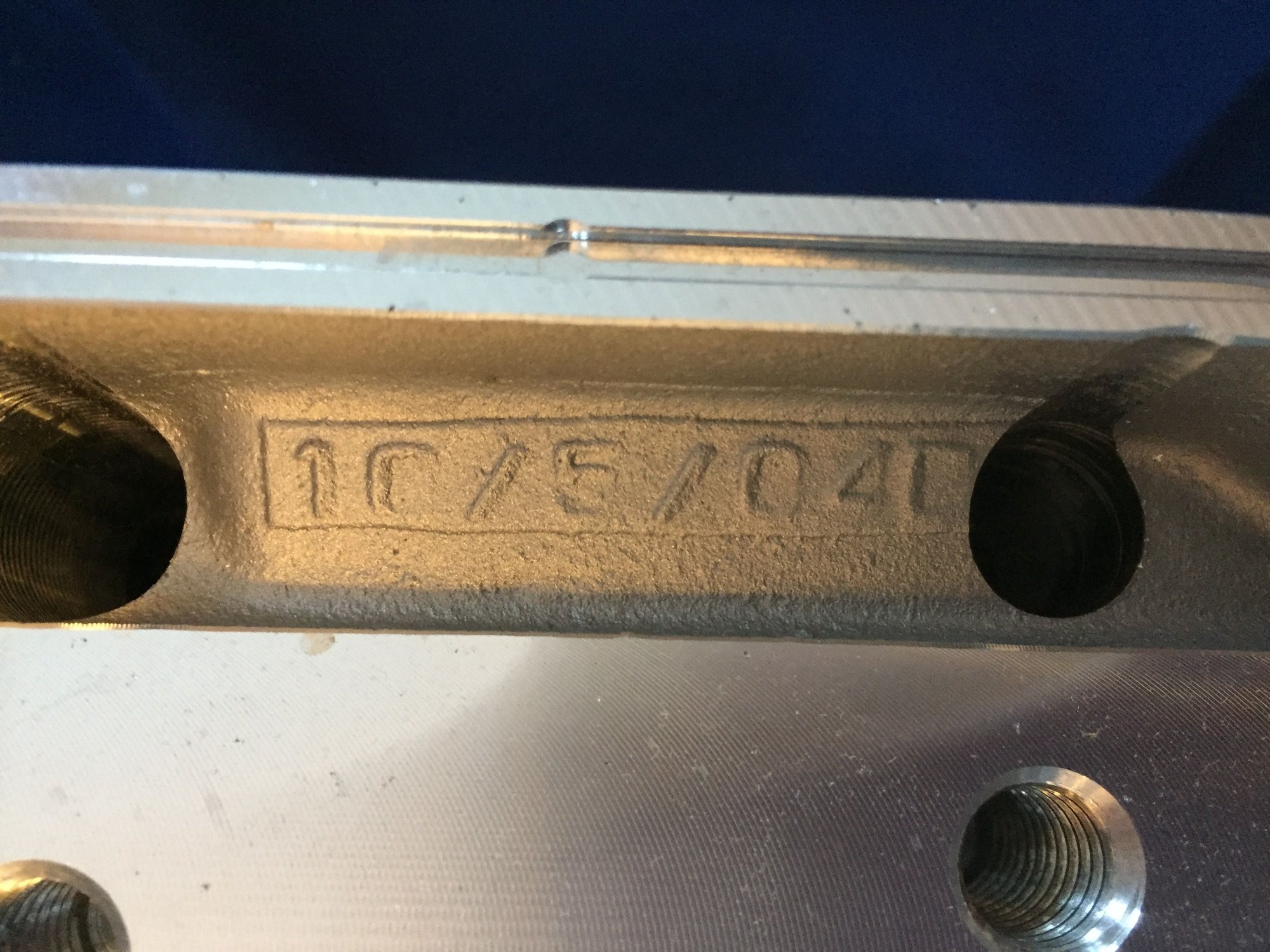

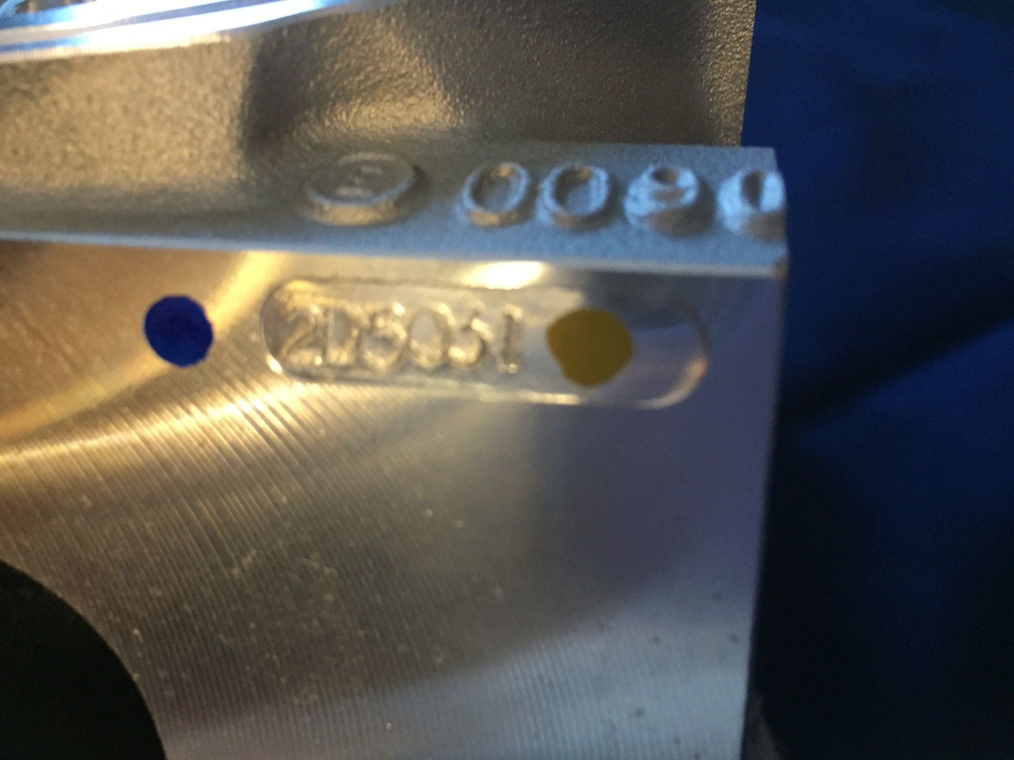

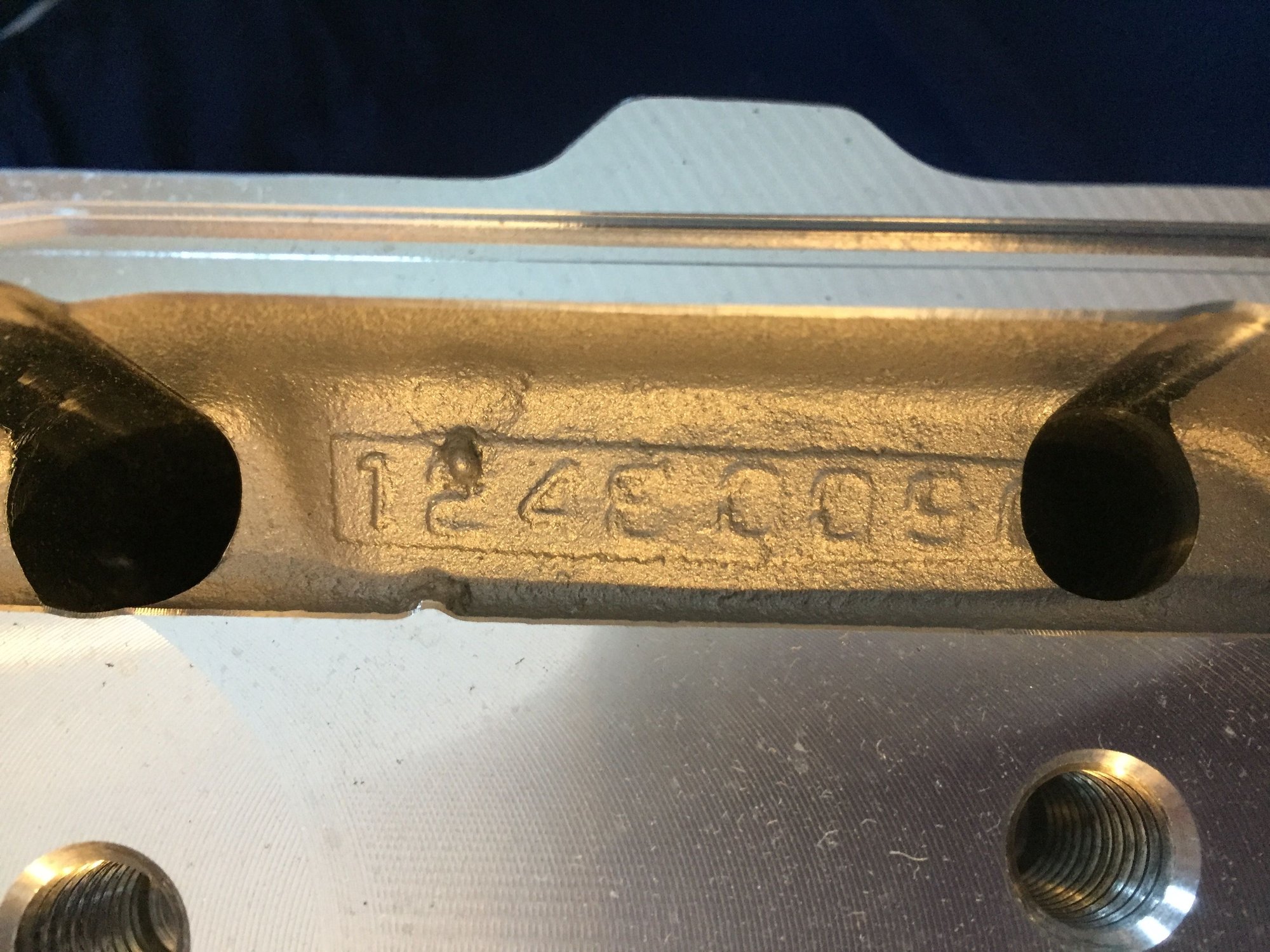

Hoping for a deal like yours at some point! Here are the heads:

Interesting how the C5R heads dont use the cast in rocker arm pedestals! This is probably the way the production LS7 heads should've been made. You have to wonder how much this design change has to do with the LS7 heads issues! According to what I was told by a guy who tracked his C6 Z06, ITBs were worth an extra 50hp on the engine dyno, over a ported FAST 102 intake w/102mm TB. This was 8 years ago, and was on the same, modded engine, only change was changing the intake and 102mm TB to 8 ITBs. No air filter was available for the ITB setup then, so that may account for some of the power gain.....
