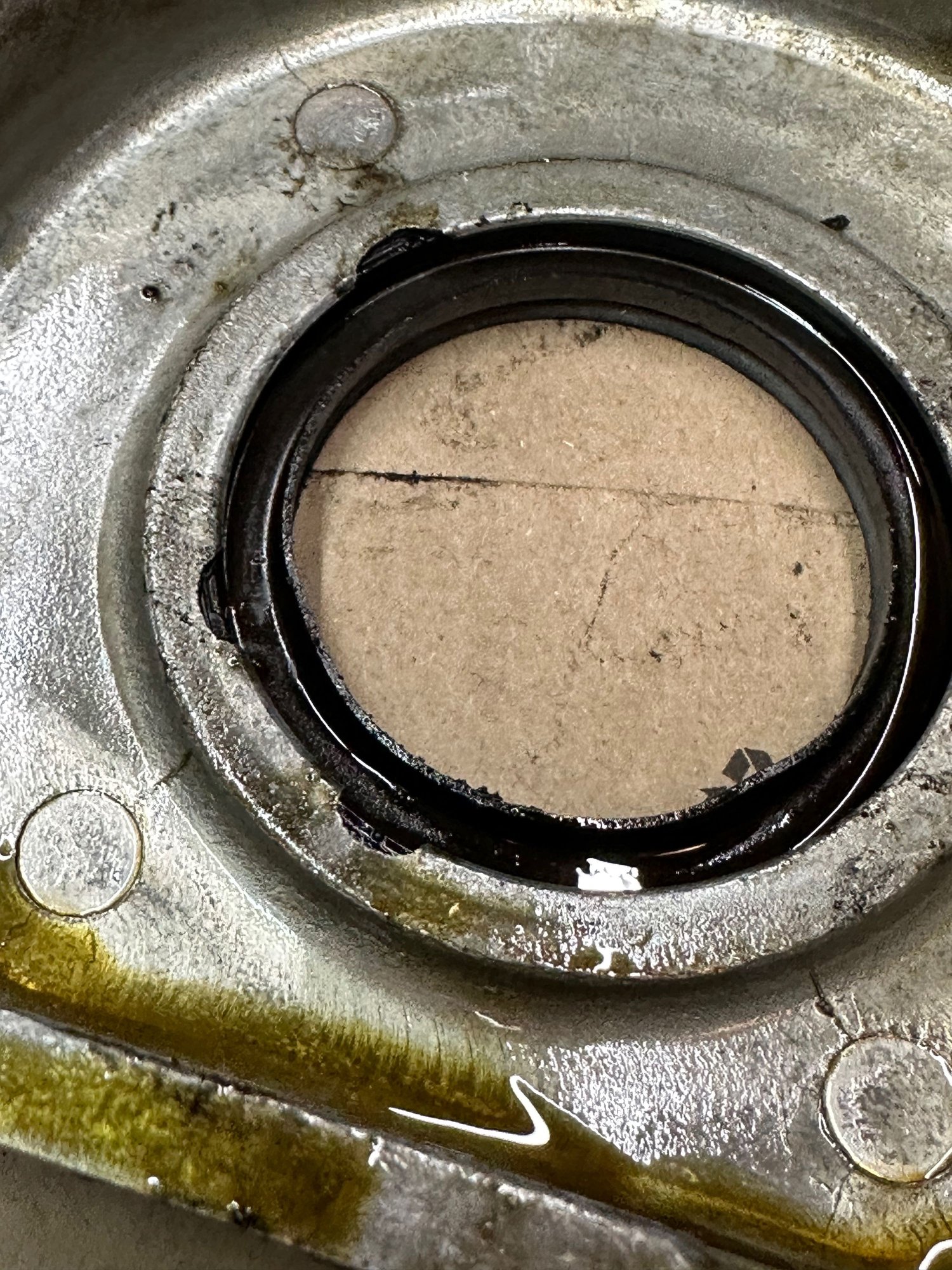

Dr., does this look normal?

timing cover off my ls6. The three semicircles specifically.

Seal is shot, other than that ya circles are just from when the part was originally cast.
You can sand it all out and polish it or have it Powder coated. Powder coating Aluminum is hit miss as it gives off gas when its baked.

Seal is shot
Beyond shot.. surprised is not a qt of oil on the floor where he parks it

maybe someone to to pry the seal out with a flat head screw driver?
That's kind of where I was at with the whole thing when I took it off - it looked pretty knackered up. From the looks of it I think everything on the front of this 145k mile engine is/was original. Water pump has an integrated thermostat, if that is an accurate way of carbon dating the damn thing. It's getting a new oil pump, timing chain, cover and seal, and a balancer. The water pump bolts were pretty rusty and the timing cover bolts had some RTV on them.
