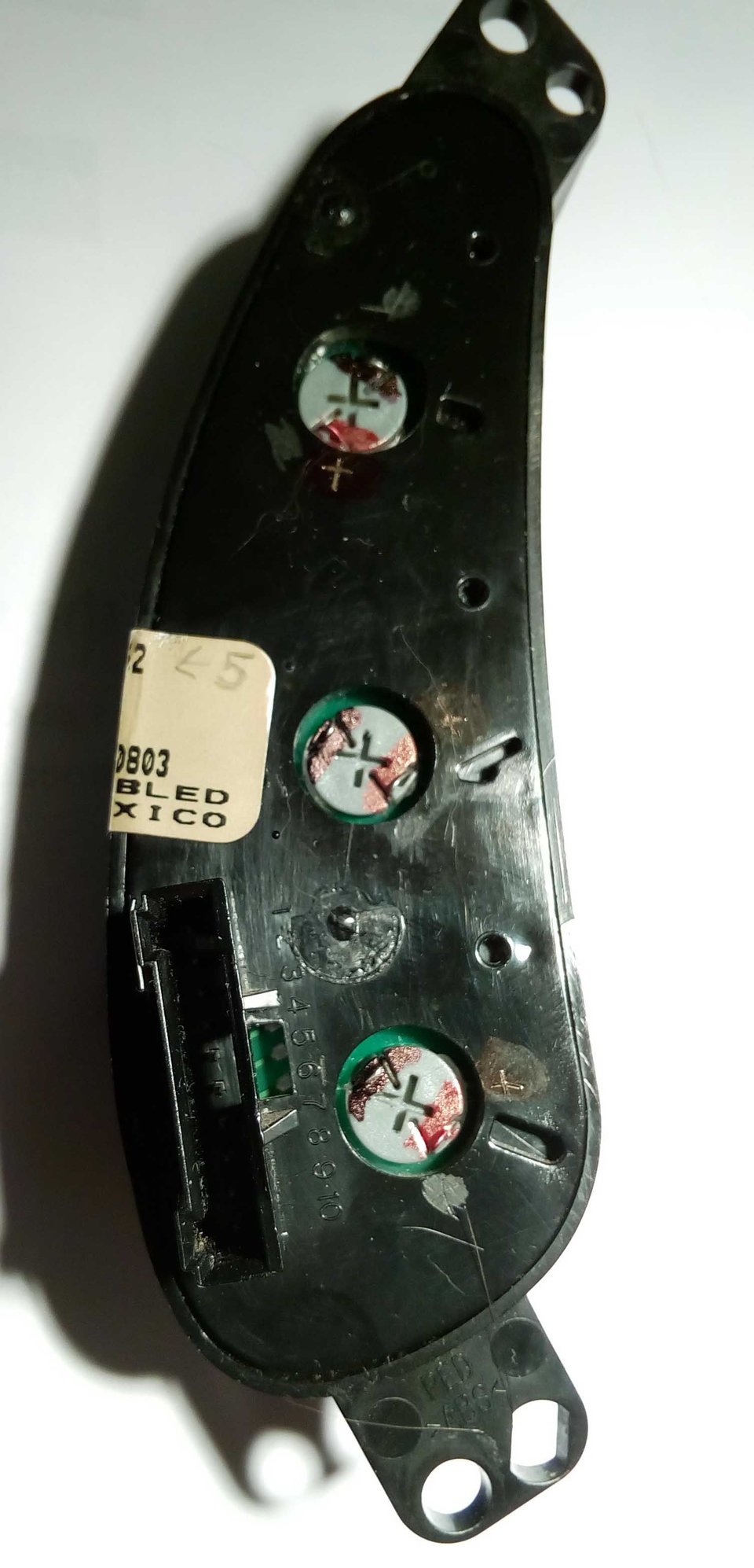

Well, big problem. I started my 2001 conv. last week and had 5 blown fuses. Dash lights, radio, heater, can't remember what else. 1st thing was replaced fuses. Checked Alternator and it was alright. 1 small and 1 really big problem now. My DIC buttons, numbers 1 and 2 the lights work, numbers 3,4,5,and 6 the lights no longer work. Are they individual lights. NOW for my biggest problem. My mileage was 107,xxx, now it is showing almost 280,xxx. This is terrible. Has anyone had this problem and is there a way to Fix it. I've never seen this or heard of this problem. Thanks

Have you tried to remove a battery cable for a few minutes. This may reset things.
There are 3 small bulbs on the switch panel. You have to remove the cluster to get to them.
Here is a pic:
Larry

Larry, thanks for your answer. Yes, the Batt. was disconnected for the Alt. check. I'm guessing you mean the whole dash has to come out for these little bulbs. While it's an inconvenience for them not working it's not worth all the trouble pulling it out.
My biggest problem is the trouble with my Mileage jumping up so High. That really hurts.

You can get the cluster out without removing the dash. There are several post here and youtube of this.
Larry
