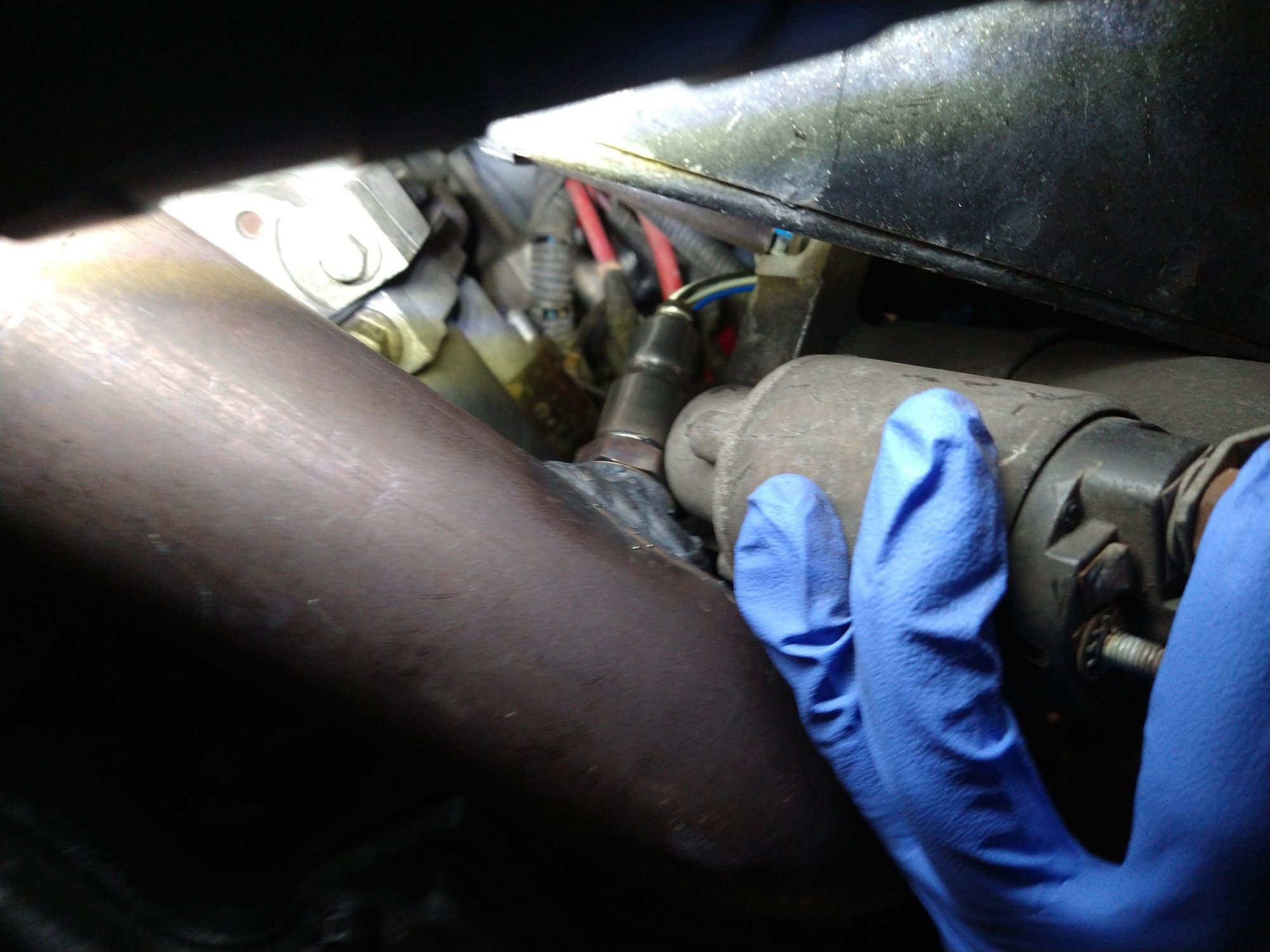

I miss typed. You should not need to remove any part of the exhaust other than the upstream oxygen sensor. Removal of that O2 will give you room to move it forward and get the correct angel to get it out. Disconnect the connector for the downstream O2 also. here is a picture of where it will come out. I have a wide band installed so I would have to remove that also.

Just remembered some of these cars had pre cats. If you have those you may have to drop the mid pipe.

Thank you, C5Mat! This gives me some hope! I understand that the 'accepted' way to drop the starter is the one shown in the shop manual that says drop the exhaust pipe, but I have skinny hands and 20 year old rusty nuts (TMI??)
I don't mind playing Tetris with the exhaust manifold and O2 sensors to get the starter out, if it saves me from having to coax 4 heat-welded nuts off the exhaust to manifold studs. In real life, I'll try to get the exhaust to drop down, but I'd hate like hell to get 3 nuts loose and then end up breaking the fourth one and having to deal with that drama. This way, if I come up against a particuarly stubborn fastener, I can rest easy in the idea that I can still get the starter out by twisting and turning it. I also happen to have a complete set of oxygen sensors that I bought when my Corvette threw a code right after I bought it. (Naturally the code never returned after I cleared it and bought 4 new sensors). I ca n finally install one or two in concert with this starter chore.
