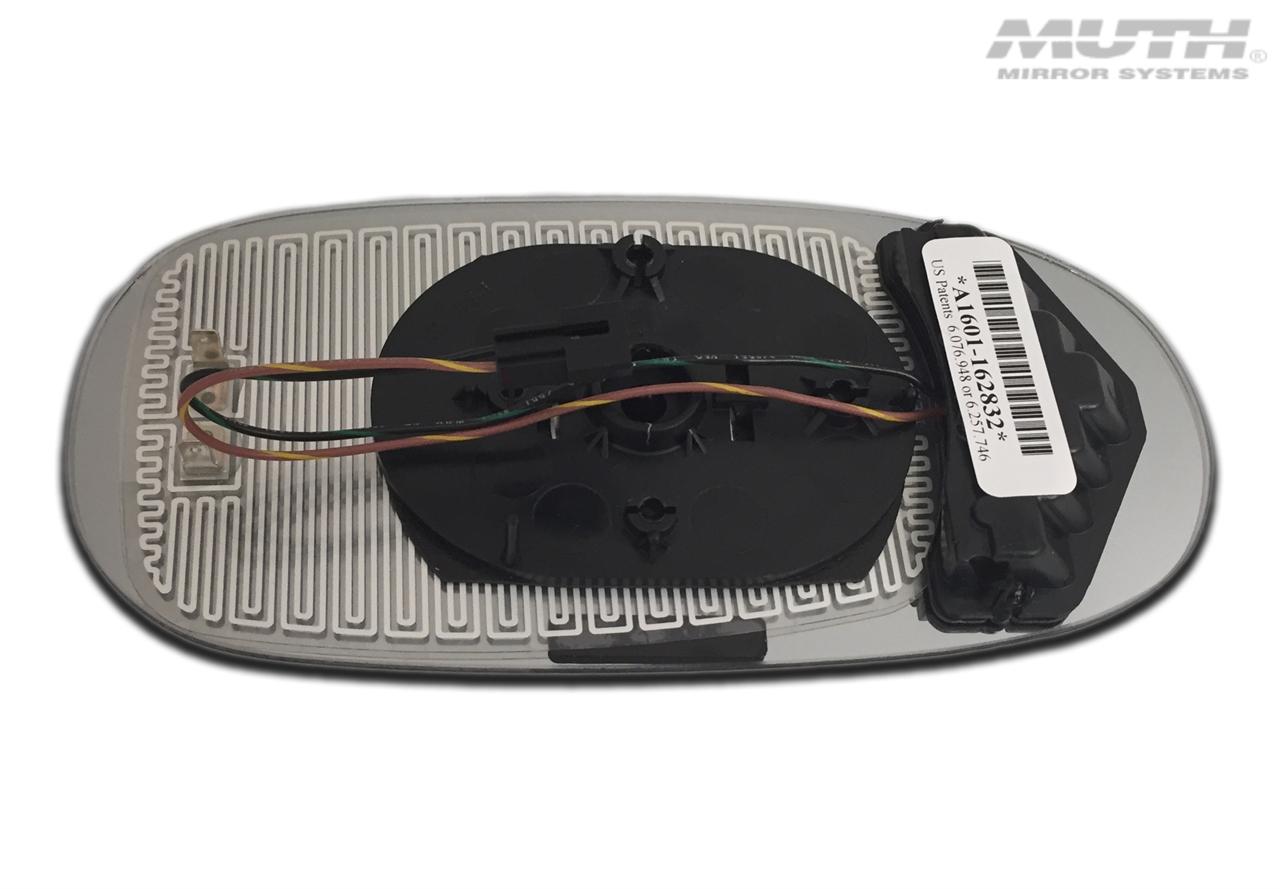

If it's just the glass...you simply pry it out with a plastic trim removal tool. It's held in with 4 small plastic ball and socket type connectors top bottom left and right

Didn't know the C5 had auto dimming external mirrors?? My 2000 vert has heated and memory, but no auto dimming I'm aware of on either side. Maybe it was optional on later model run cars? Learn something new every day...
You can only have the external dimming mirror (driver side) if you have the internal dimming mirror. If you have the regular manual mirror inside you can't add the dimming outside mirror because the wire harness doesn't support it

The option code was DD0
This is straight from the manual.
Electrochromic Day/Night Inside Rearview Mirror with Map Lamps (Option)
Your vehicle may have an automatic electrochromic
day/night rearview mirror with map lamps.
This mirror automatically changes to reduce glare from
headlamps behind you. A time delay feature prevents
rapid changing from the day to night positions while
driving under lights and through traffic.
The mirror includes two map lamps and an automatic
dimming function. There is also an interior console
flood lamp located underneath the rearview mirror
which remains on at all times.
The automatic dimming feature is turned on or off by
pressing the IO button located on the lower part of the
mirror. Press and hold the IO button for up to three
seconds to turn this feature on or off.
When cleaning the mirror, use a paper towel or similar
material dampened with glass cleaner. Do not spray
glass cleaner directly on the mirror housing.
Driver’s Outside Auto-Dimming
Rearview Mirror (If Equipped)
The driver’s side outside mirror will adjust for the glare
of headlamps behind you. This feature is controlled
by the on and off setting on the inside electrochromic
mirror. See “Electrochromic Day/Night Inside Rearview
Mirror” in the Index.
