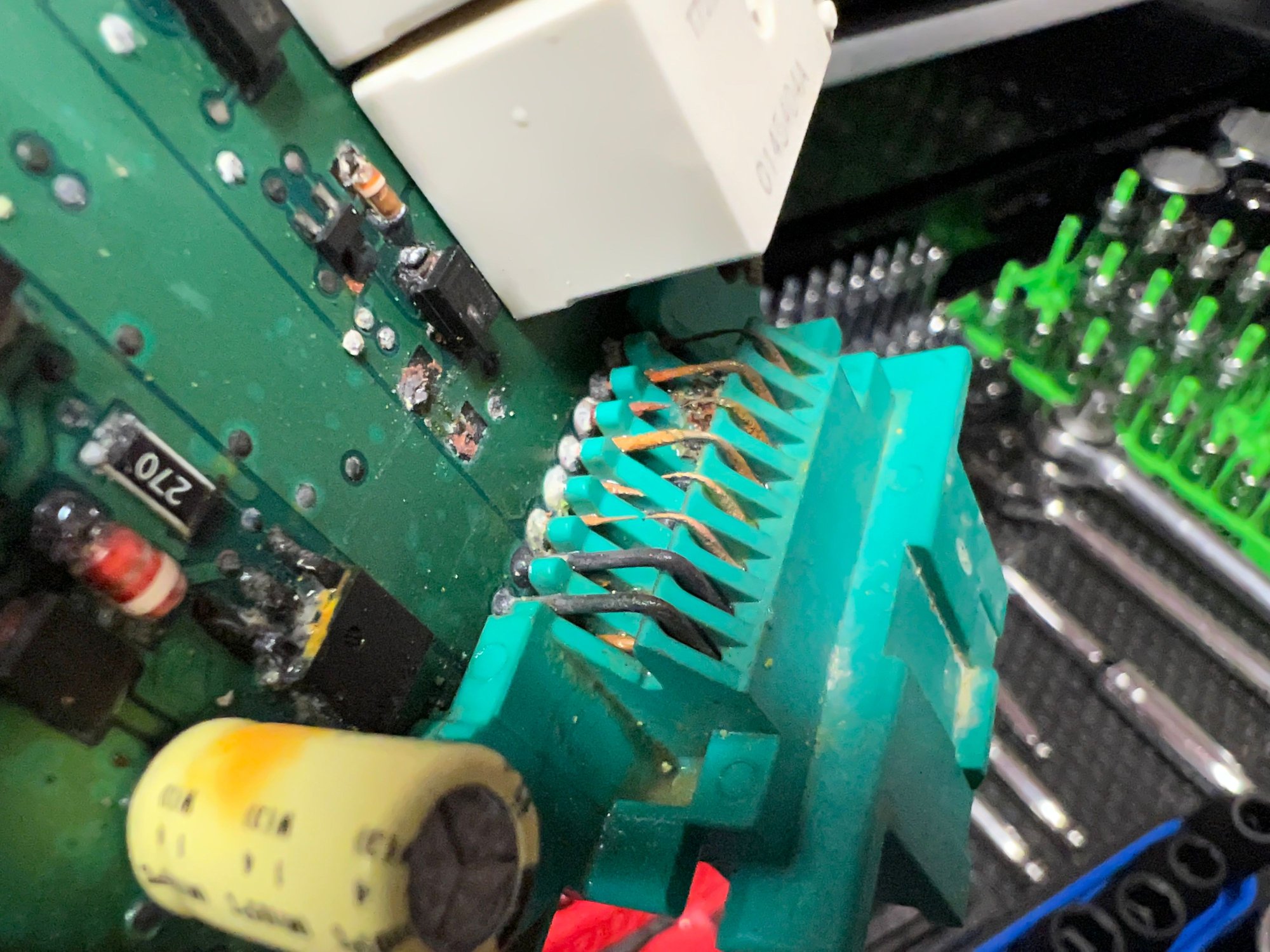

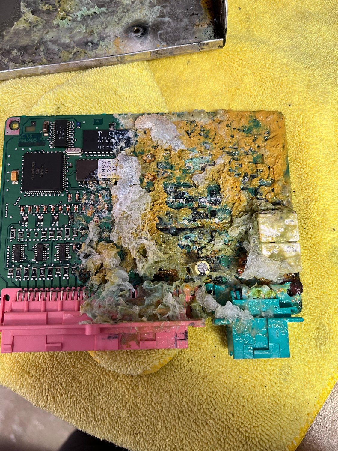

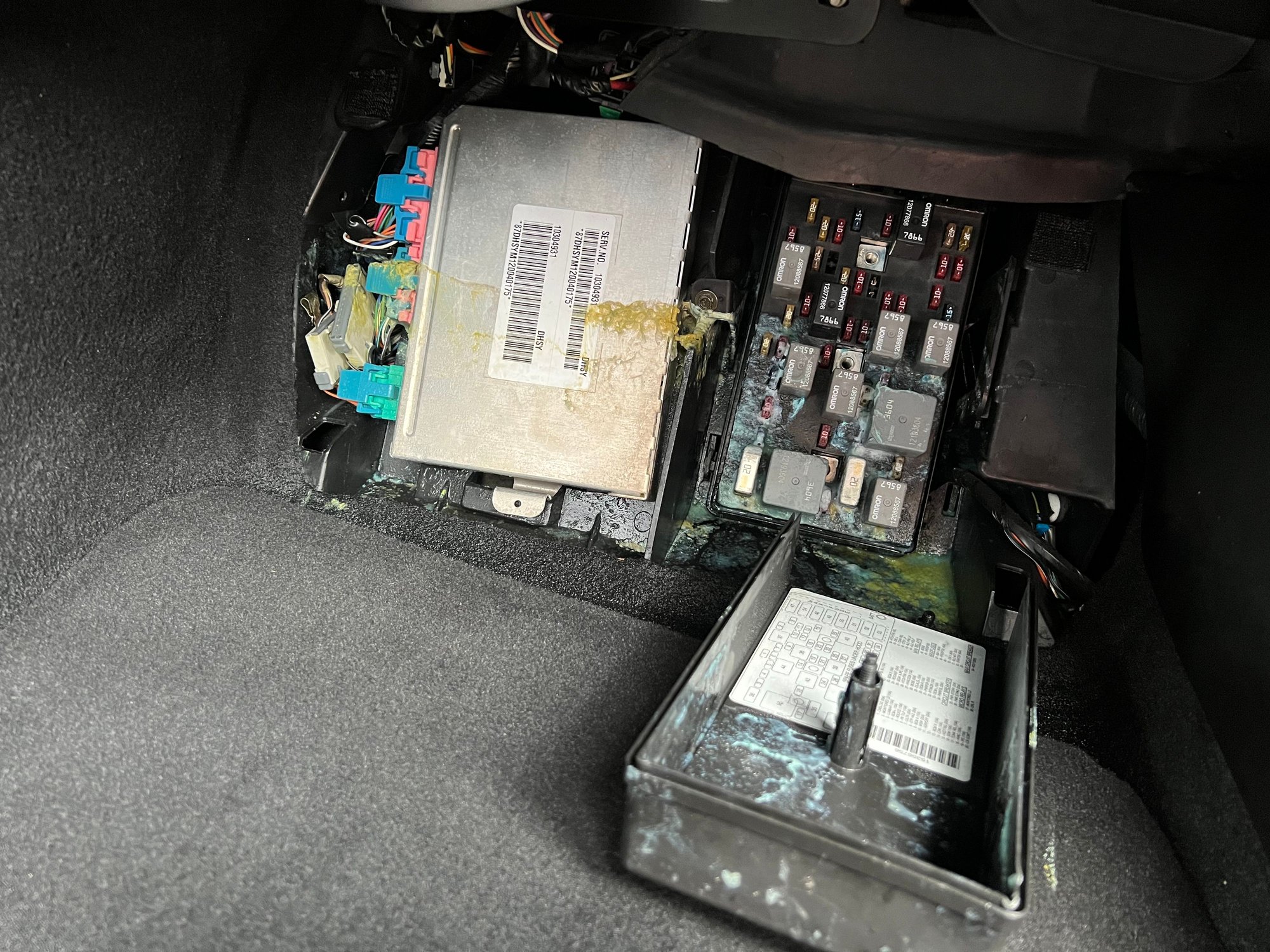

We had heavy rainfall and high tide here on long island, NY, the day before Christmas. My 02 c5z was parked on the street and was flooded, not to bad but bad enough to damage the Body Control Module and corrode the fuse box.
In the rain i pulled the seats out and sucked up all the water from the carpet and pulled all fuses and BodyCM. Proceed to spray the fuse box and BCM connectors with electrical cleaner and began to disassemble the BodyCM to asses the damage.
The BCM has corroded pins and don't see it being salvageable. The fuse box looks promising once all relays are replaced. Once i replace the replays ill diagnose further in needed.

That corrosion happened in one day? Looks like it was in the ocean for a year.

Less then three hours.

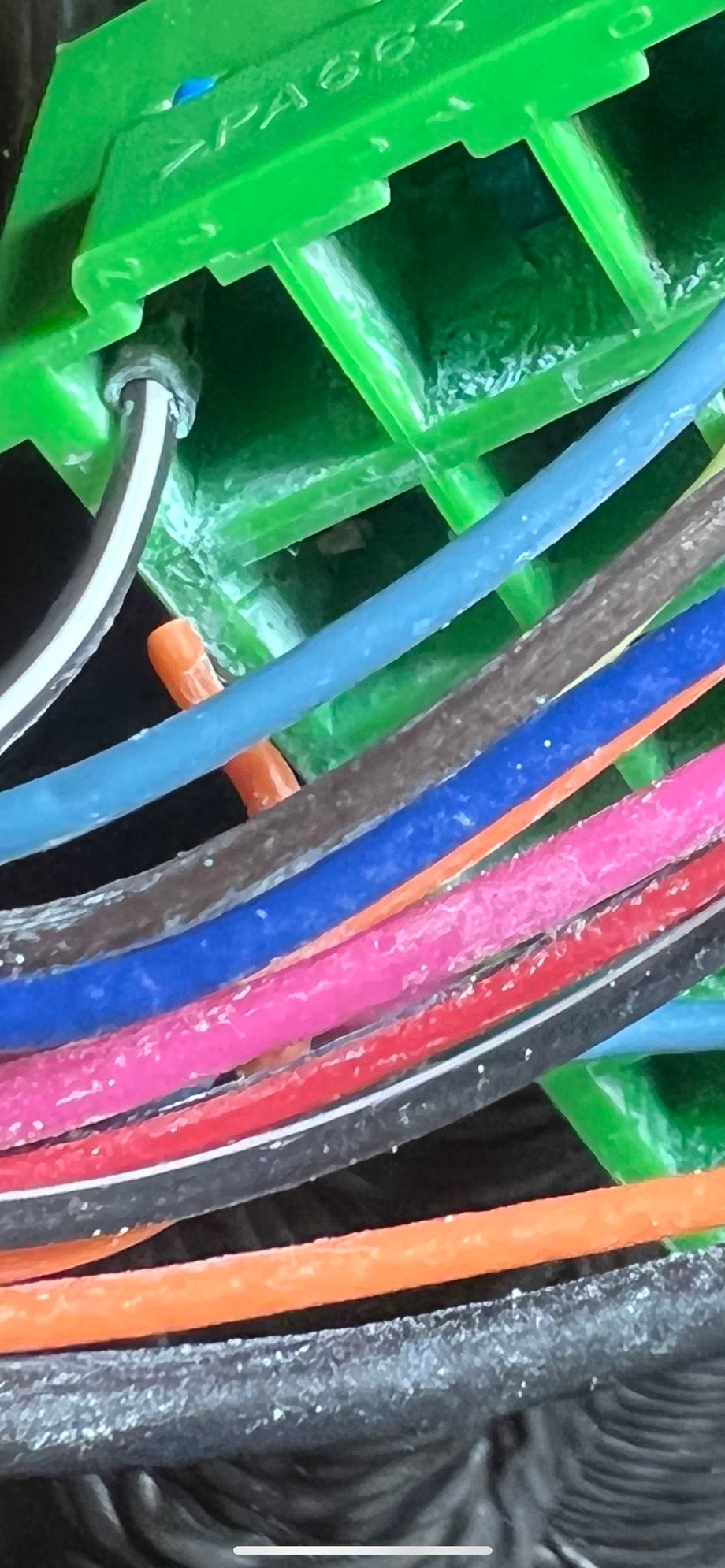

Looks like i need to fix this pin, does someone have access to a wire diagram to this pin ? looks to be B12. Its from the back of the interior fuse box, bottom most connector.
Anybody know where i can buy a new pin to replace it once i de-pin the harness.

Automotive connection pins and plugs are available all over. Amazon is one.
