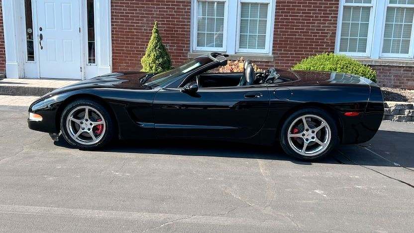

Just bought ‘99 vert at Mecum. I’ve changed all the bulbs for the directional signs but the left side still quick flashes. The parking lights all work. The rear lights all work. The 4 way flashers only work on the rear. Could it be the 4 way relay causing the LH to quick flash?

Congrats on the car and post some pictures.
