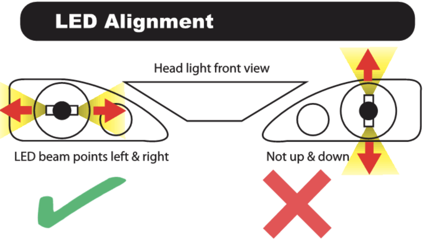

In factory housings? You'll need to get the model that has the adjustable lock ring. You'll want the LED chips to facing the 3 and 9 o'clock position. If not your low beam cut off won't be correct and you'll blind the hell out of people.

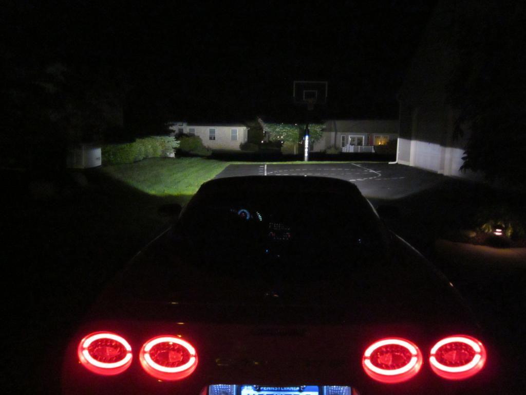

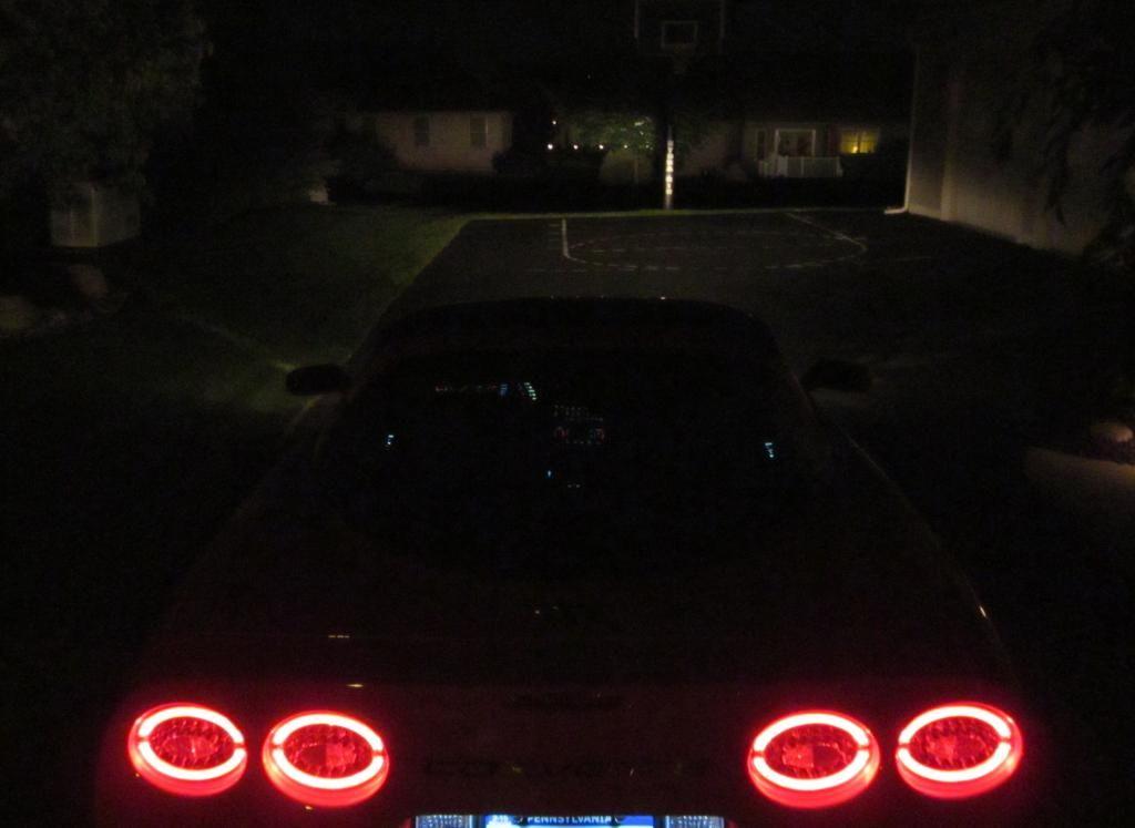

This is very true. The factory headlights create a pattern designed to maximize the effectiveness of a weak 1000 lumen halogen bulb. That pattern doesn't change much when you install an HID or high output LED bulb, it just gets brighter. The additional output reveals the horrible pattern created by the lens resulting in increased glare (which not only blinds oncoming traffic, but hampers the driver's long-range vision) and the scatter from the pattern is highly distracting as well.
Compare that to our dedicated projector-based headlight system. Take a look at one of the comparison photos a customer sent: (Note, this is our older Bi-Xenon kit, our current LED projectors are even brighter.)

Wow, Radio Flyer, That is amazing! What a major improvement!

Auxito leds worked fine for me. Didn't need to spend all the money on all the housing replacement ideas that are out there. The other poster mentioned three to 9:00 but it should actually be vertical in the housing 12 and 6:00
you want the LED chips to be pointed at the 3 & 9.
