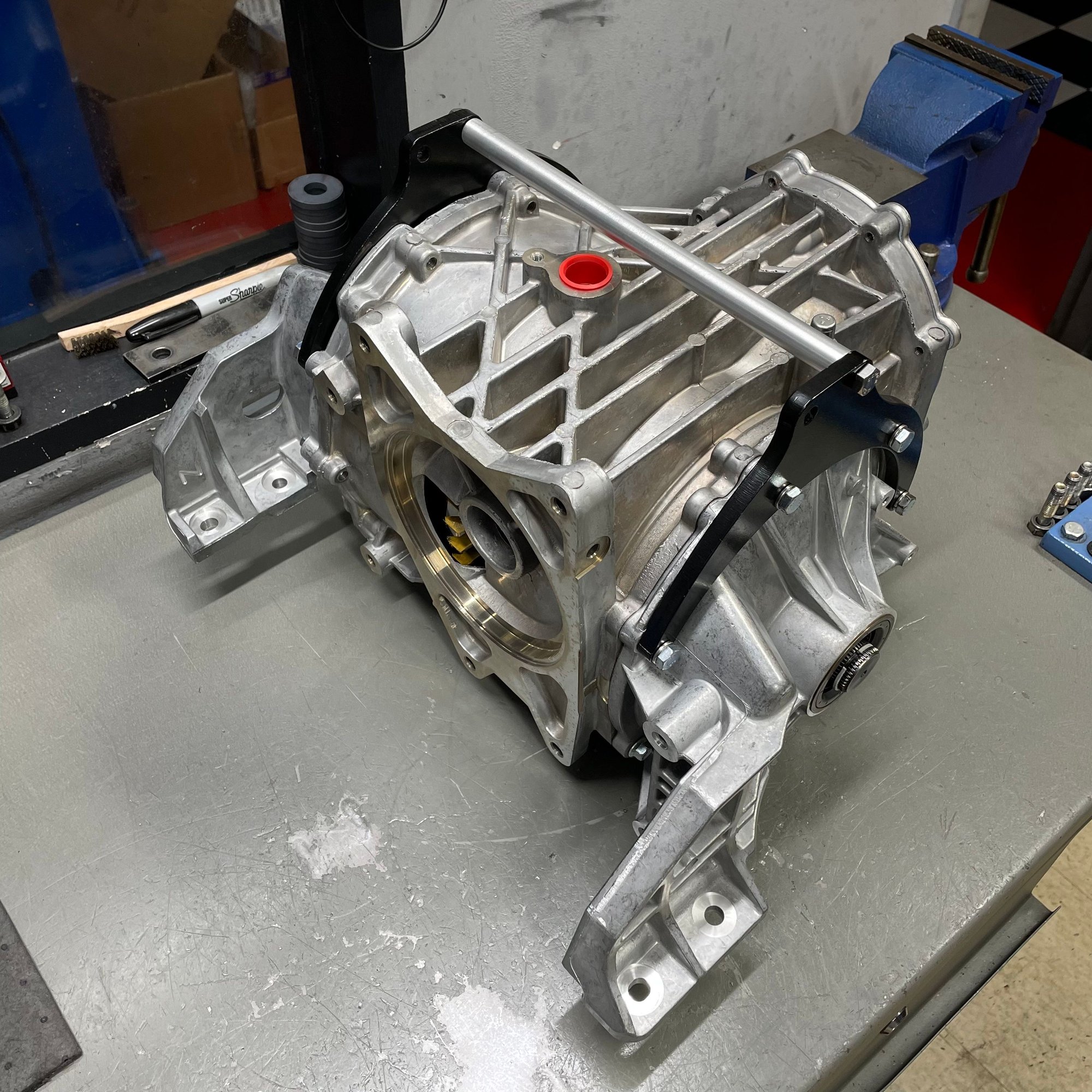

You should consider it if you're swapping to the TR6060 since 05-07 are the same as the T56 you currently have. There are 2 ways for the swap. We have built TR6060 that will bolt directly to the C5 diff or replace the trans/diff combination to 08-13 Z06 set up. The second option is more expensive but we have customers making well over 1,000 RWHP with that set up.
This one was built for a road course set up.

You have to use our offset differential mounts to make this conversion work.
When anyone buys are mounts, it comes with our support for the conversion. Let us know when you purchase/build and we can go over all the specs for modifying the exhaust.
