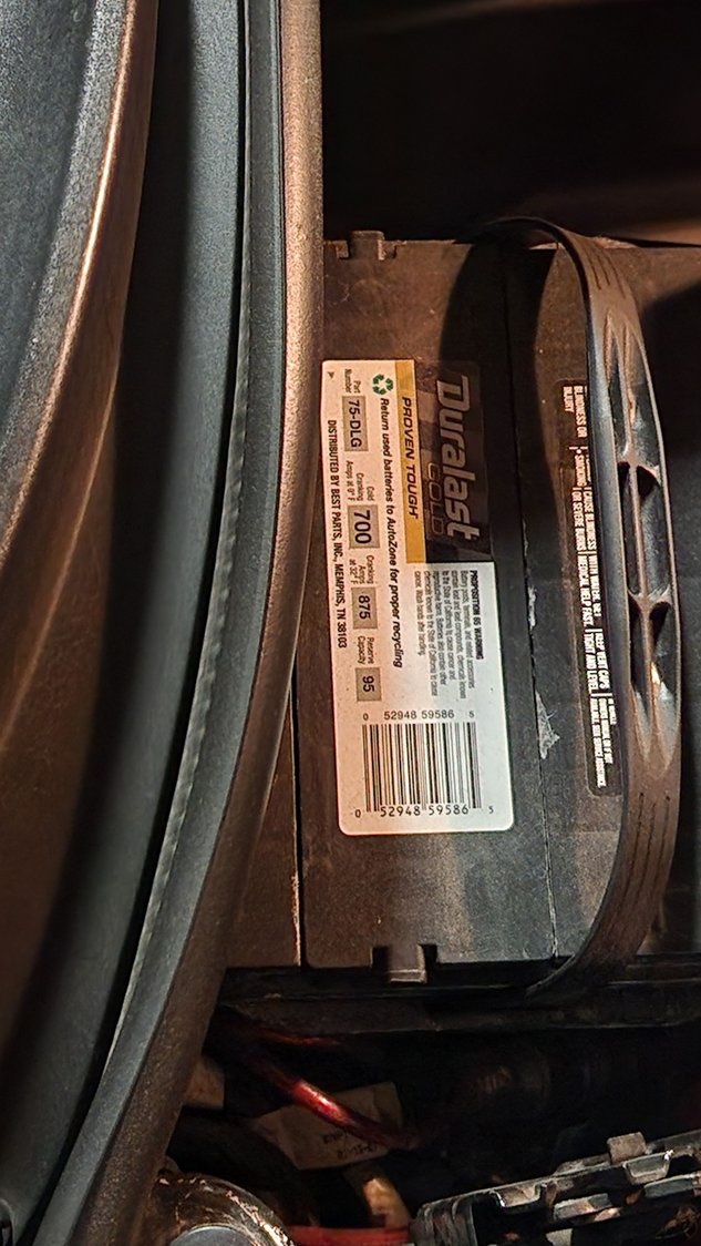

I have always had good luck with the Duralast Gold(Autozone). Run them in my Jaguar and
Dodge truck.

Replaced it last year. Had a 3 yr AC Delco. Lasted right at 3 years.
