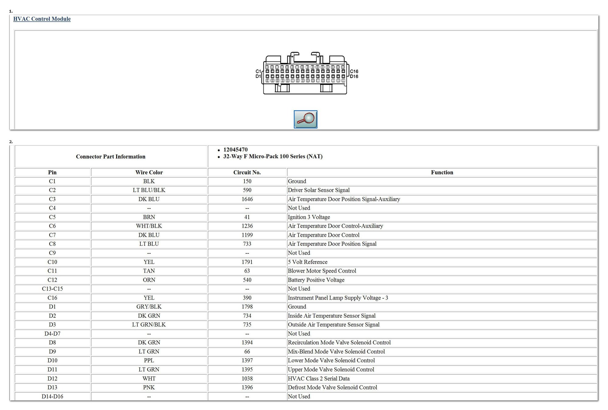

As Rob mention above use the T-pin and do some more measurements :
Disconnected HVAC plug:
  • Measure ground path quality (resistance -ohm ) between a chassis ground and C1 and D1
  • Measure Voltage between battery negative and these pins : C5, C10, C12, C16
    Connect the HVAC plug and measure the same voltages again with module
    May Rob has some more info/advice to add ?
Hopefully these measurement can give some more info .
