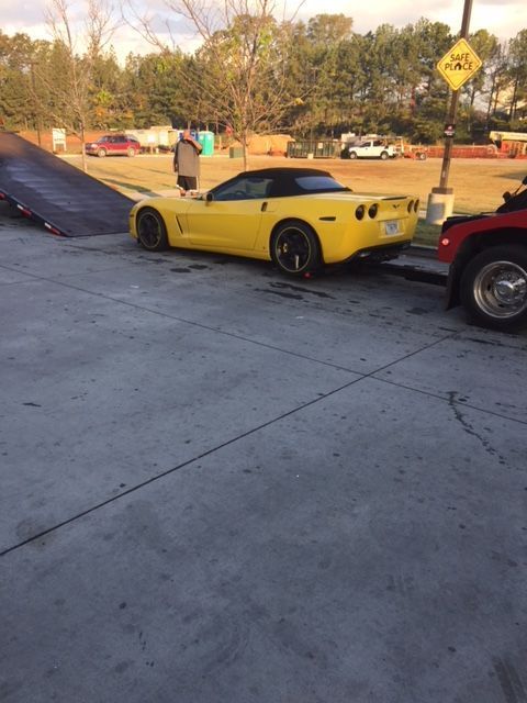

Happened to me 3 years ago when I had my C6. Stuck in park facing the curb. Flatbed couldn't get it on the truck because of that. This is how they ended up doing it. Don't ask me about how we got it off the truck...............it wasn't pretty

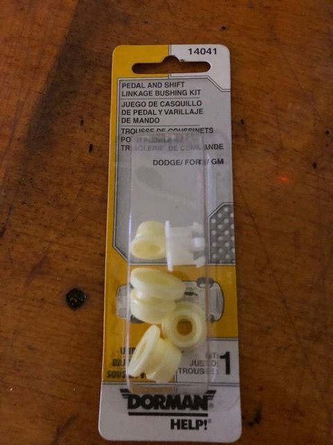

Originally Posted by RedC5
Anyone have an actual picture of this grommet and cable setup from under the car? This is scary thought can break anytime 😲
Here's the Grommet. There are several in this package but only one is needed.
On my cable the end that came off, the part that holds that grommet, was actually cracked. I saw it laying on the ground and looked at it with the tec. Nice to know you can buy those though.
I wonder why they didn't put dolly wheels under the back tires? Then it would have rolled fine.
