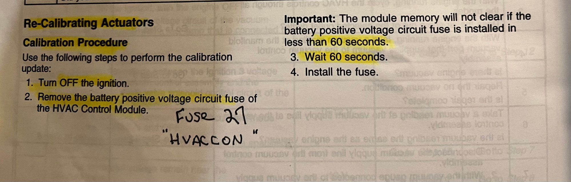

Sometimes low Freon will cause this but one side usually passenger will be cold and drivers side will be not as cold…are you using heat or AC ??…yours may be a blend door actuator and we can try a calibration by removing a fuse…with the key on turn the temperature **** on the drivers side and you should hear (if you have decent hearing) the actuator motor move…try the same with the passenger side…you can actually remove the glove box and see the actuator looking inboard…see pic…you will see the round gear rotate.

Do you mean B0365 and 0367 ???….if they are these 2 DTC’s are for the passenger side air temp actuators…the HVAC module is seeing less than 0.09 volts on the signal circuit for the B0365 and more than 4.90 volts for the B0367…if you watched the video and using a scan tool you can look at those “counts” (voltage) and this would help in a diagnosis…if the screen is blank you may have 2 separate isssues…the driver side may be good so I would turn the key on and turn the temp **** on the drivers side and see if you can hear the motor operate…you can remove that glovebox and see if the motor gear rotated as you slowly increase and decrease the temp…if neither work and since the screen is blank I would pull the module and see if you have a good power and ground to it…you can try a recalibration for the heck of it.

Pull fuse #27 for a minute in the footwell fuse box. You'll hear the doors actuating for a bit and it should reset. I've done this no less than 4 times on my car. It will make each side temp different. Also, when I was having an issue, when I turned the key I could hear the doors working. Not so when it is working correctly. Search function working great on the site. I just looked up an old post pertaining to exactly this problem. Great luck!
One more thing. If you spin the dial on your heat setting it will screw up the system and you'll have to do this again. Be gentle and notch it up or down. NO SPINNING! It effs it up!

Thanks for the idea. Did not work tired it more than four times. On to the next.

The fuse you suggest removing is it #27 on the passenger's side cabin fuse box? Tried removing that one and waiting 60 seconds before reinstalling it. Tried that four times as another member suggested. Unfortunately, that didn't work.. Will retry listening for the actuator motor. Thanks.
