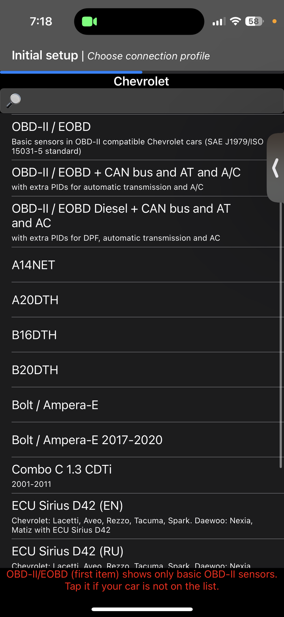

I ordered a (admittedly cheap) OBD2-to-Bluetooth adapter to use with this (well-rated) app.
I can connect to the fob via Bluetooth just fine, but the fob is having a hard time interfacing with the car. I suspect the issue is that I’m not using the right protocol.
Can somebody tell me what type of protocol I should be selecting in the attached pictures?

C5's class 2 data bus operates on the SAE J1850 protocol so the 2nd from the bottom should work !!
