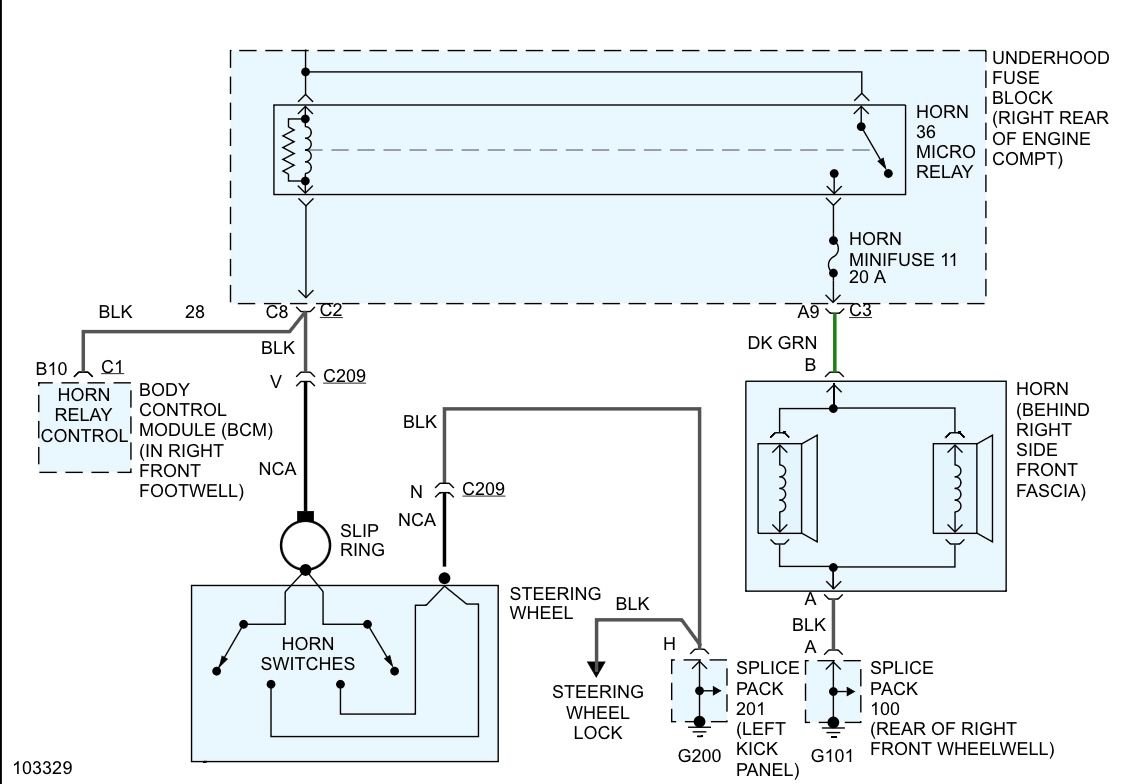

Confused !!…your first post said your horns don’t work but in your last post you said it’s stuck on…so what is the deal with the horn ??… you removed the fuse but still get a clicking under the hood ??…do you own a DVOM and a 12 volt test light ??…OE and redrawn wiring diagrams below…can you interpret this wiring diagram ??

Sorry man. I was reiterating what was stated in the first post to make things clear. Thanks for the diagram. Appreciate it. I am no good with electrical. I have no idea what I need to test, etc. But thanks for helping.

OK, got ya !!…horn NOT stuck ON but now just clicks from somewhere under the hood…if you hit the “panic” button on the key FOB does the horn sound ??…the clicking is most likely the load side of the relay energizing or maybe the horns not working…so my recommendation to you is to remove mini fuse 11 and with a 12 volt test light connected to battery positive touch the tip of the test light to each one of the fuse terminals…one of the 2 go to the horns so we are directly powering the horn with the test light…this is terminal A of the fuse…if you don’t have a test light a length of wire going from battery positive to terminal A would work !!…if the circuit is good from the fuse to the horn the horns should work !!

I’m not sure you’re understanding….ok, do this…remove the fuse…connect test light to a good ground…if the relay is NOT energized as it should be the test light will not light probing either of the 2 fuse terminals…if it does light the relay is energized and the horn should sound if you reinstall the fuse…if the light illuminates in either of the 2 fuse terminals pull the relay and if the test light goes out the relay indeed was “stuck” on…you have another issue then..,it would be easiest for you to remove the horn and with 2 jumper wires feed it power and ground from the battery to see if it works !!

50 ??…it’s 80 here !!…Yes, just hotwire the horn with a power and ground !!…there is a small access panel inboard of the passenger front tire and you’ll find the horn there…remove the connector and bolt and pull it out !!…one terminal of that fuse goes to the horn and that is the one we are trying to give power to and make the horn sound…if the relay is NOT “stuck closed” (I think yours IS) the fuse should not spark when you install it !!…the horn membrane may be bad !!…if the relay is stuck closed a test light will light on one of the 2 terminals of the fuse when it’s removed with a test light connected to a good ground.
