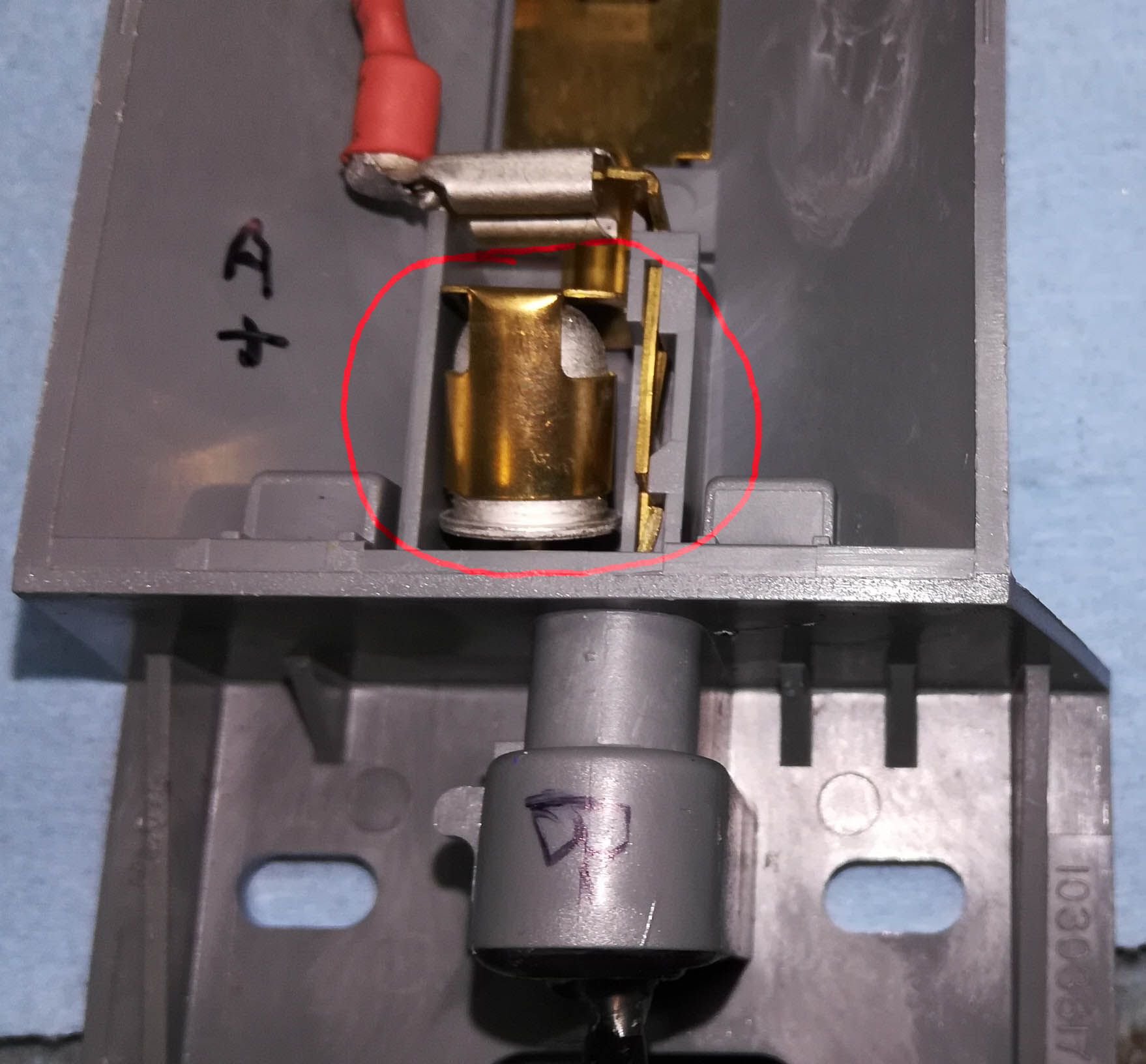

LWSZ06's Avatar
LWSZ06
Joined: Sep 2009
Posts: 464
Likes: 160
From: Port Birmingham AL
Here is the tilt switch
Larry
Old Mar 17, 2023 | 08:19 PM
Bob Onit's Avatar
Bob Onit
Joined: Mar 2006
Posts: 3,342
Likes: 7
From: Connecticut
Thank you, Thank you,Thank you Larry!
It looks like weighted switch. The pic is a HUGE help.
Rob.
