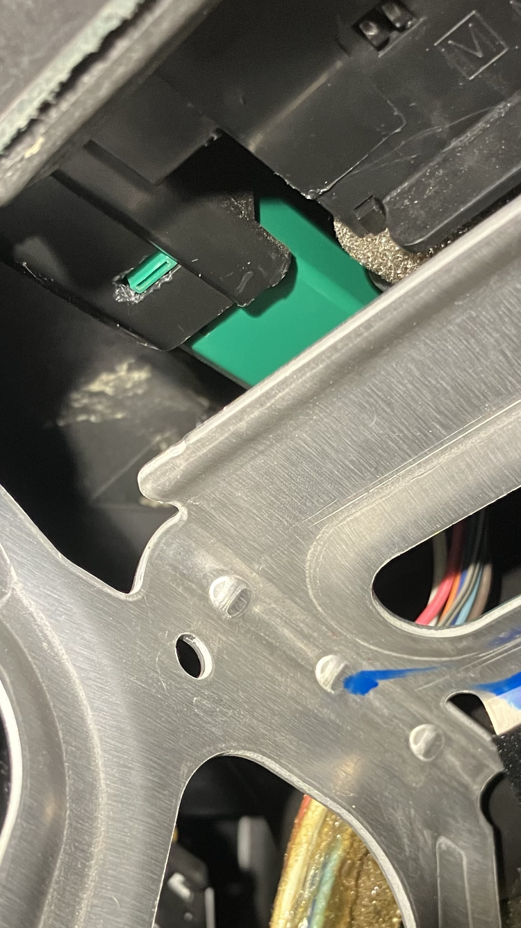

I did quite extensive research on this forum as well as Youtube (Froggy, etc.) on how to replace this switch. Here is what I found that could be helpful to others.
1. Driver's knee bolster has to come off. At this point, I would try to see if the switch will easily be pushed out (i.e., maybe its already loose or the tabs are broken. You can also try placing a screwdriver on the switch and hitting it pretty hard once or twice to see if it will come loose. Mine did not. If it wont come out easily, go to step 2.)
2. Center console and radio has to come out. I know there are people out there that say you can simply just reach up through the knee bolster and push the bottom tab on the switch. However, this i nearly impossible. Its actually quite difficult to even get your hand on the switch let alone depress the bottom tab. And its nearly impossible to get a screw driver up there to depress the bottom tab. I tried for about an hour before giving up.
3. To get the switch out, is a TWO person job. One person reaches up through the radio with a screwdriver to depress the bottom tab and the other person takes another flat head screwdriver placed at the top of the switch and hits the butt of the screwdriver fairly firmly. The switch will come out. To install the new switch one person slides it up near the hole and the other person grabs it will needle nose pliers aligning it. Then push in firmly from behind. I tried this method a few times on the old switch to knock it loose and it worked every time with no issues.
Some people say that you can get a thin screwdriver in from the front on the top to depress the top tab. I tried this for quite a while. First, you will damage the vent surround and second its difficult to get enough leverage to depress the tab downward. This is worth trying but I had absolutely no luck with this method.

Tried posting some pictures. but doesn't seem to be working. Sorry. I will try again,
