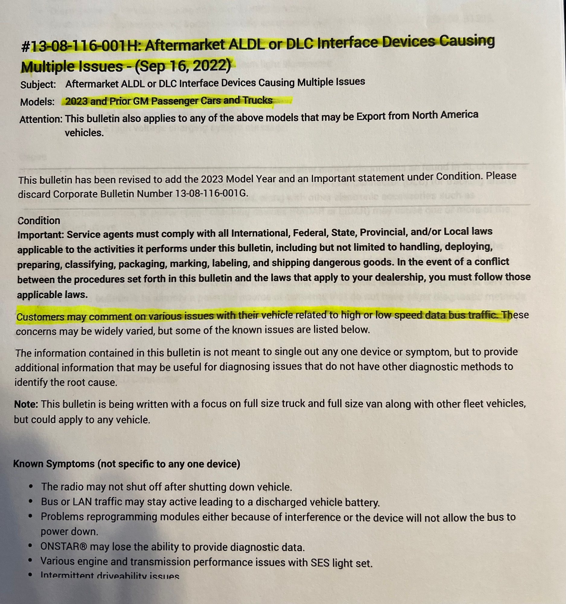

I have a window valet plugged in and every so often it goes crazy and does some weird stuff. I unplugged it this morning to see if that would change anything.

If this “gadget” is plugged into your DLC don’t plug it in…keeping something like this plugged in can cause a lot of issues with the cars communication…there is a TSB for this !!
I have a window valet and leave it plugged in all the time. Has not affected anything. If its failing in some way it might affect the databus. Lots of people have one installed. Easy to test if its a problem by leaving it disconnected and seeing if the car still goes crazy.

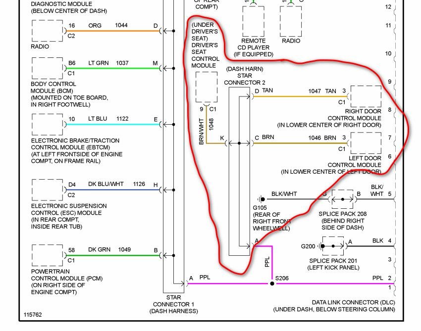

You can try to remove the starconnector for door/seat modules and see if your car stop behaving crazy .
This act disconnect the serialbus to these three modules and if any of these modules or serialwires are broken or partially broken these alarms
your serial databus problems should end . But door/seatmodules will not work while your doing this check .
This starconnector has three wires as shown on the schematics below
(If you disconnect the other starconnector with more wires your car would no be able to start because the PCM/BCM are disconnected from each other)
