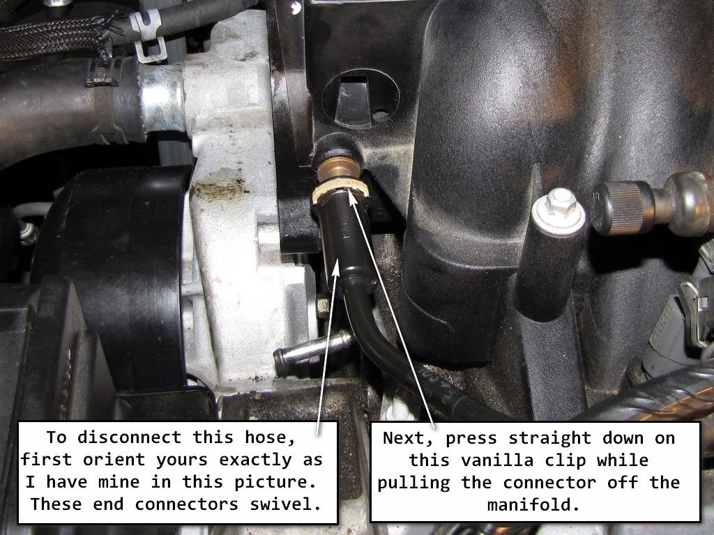

The P0443 is a purge valve "circuit" code which tells me it's either the purge valve or a wiring issue...the 0442 is just a small leak and the purge valve in the picture is located on the drivers side of the engine as you can see in the pic and can be reached from above...Val Skinner was her name and she retired from the Tour when she developed some shoulder issues...was amazed when we would go to the golf range where we lived and she would just bang them out consistently 250 yards straight as an arrow !!

Ok Got new purge valve. However, I remember someone writing about the little white plastic clips on the hose connection and said he broke them and they can't be replaced. One guy showed a pic of taking a screwdriver and pressing down on it to release the hose. What's the best way to unhook the hose? I knew Val Skinner. I believe she lived in New Jersey back when I played in the Atlantic City Shoprite Classic. I was the person who organized and implemented the Jr. Kids Clinic for that event with the corporate sponsors.

Val lived in Bay Head about 1/2 mile where I used to live...picture below !!
