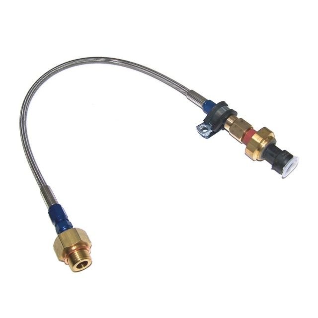

This is what mine looks like
Larry

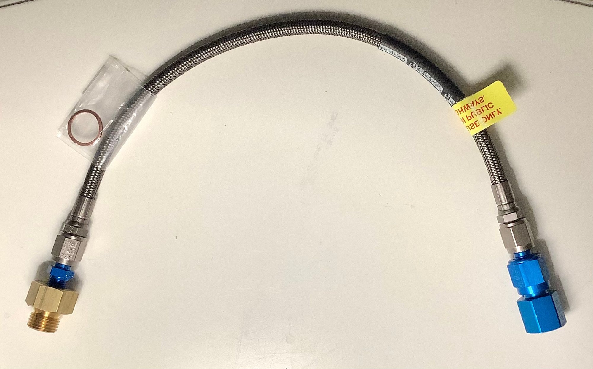

This is the first try with an Earl’s hose with a Chevy adapter. I wanted a gauge, but two hoses and three gauge fittings later, none would screw into the Earls hose. The other fittings seems to work fine, just not the gauge port fittings.
I got a refund on the hose, so someone gets a deal. Just don’t plan on screwing in a gauge port!
