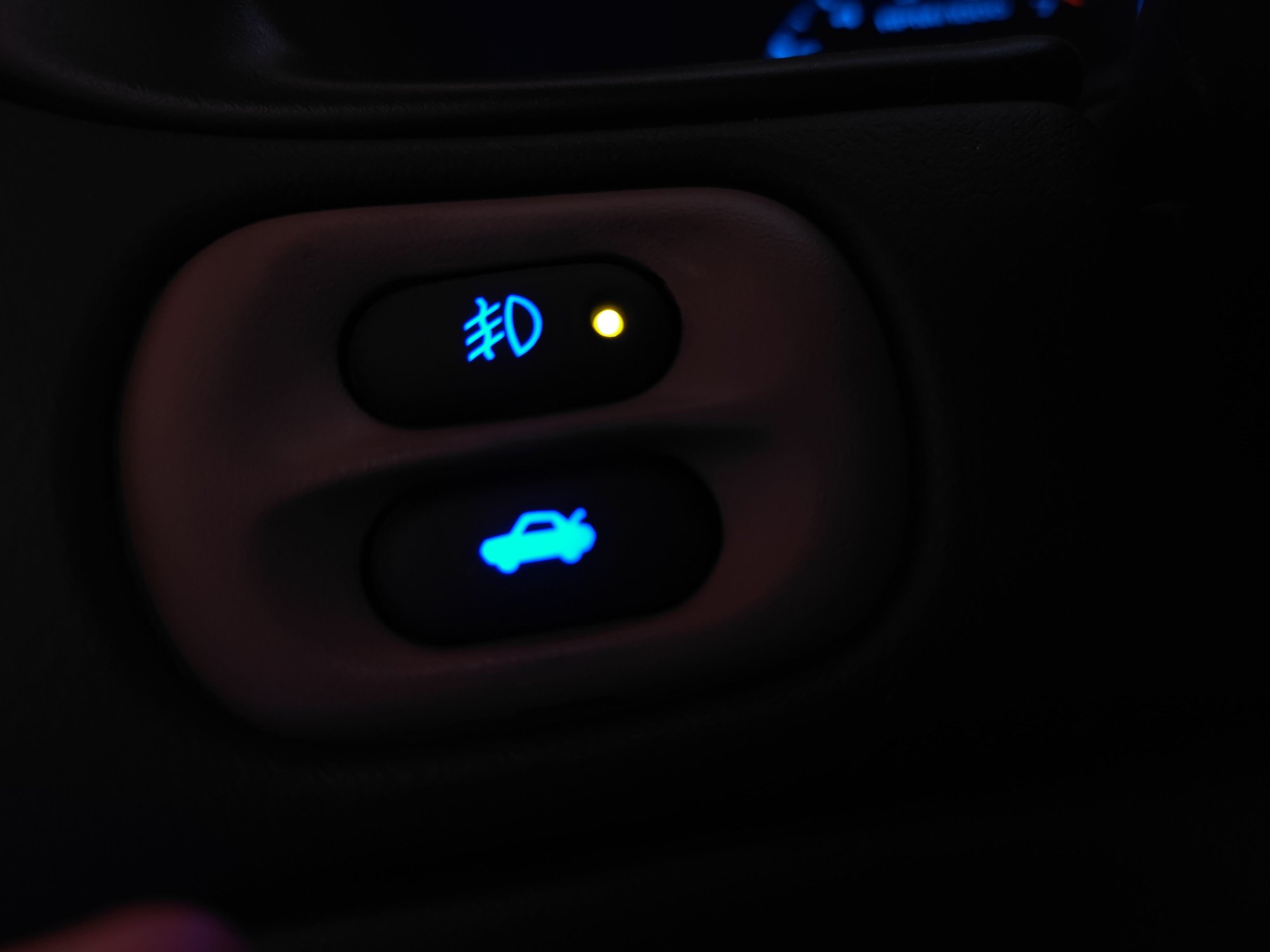

They're 10mm neo wedge bulbs for door switches, fog switch & AH switch. i think they're the same for the DIC but I haven't been in there in a while.

I bought 10mm bulbs and they fit perfectly as far as the base size.
The head was a bit too wide and I had to trim the board with the nail clippers
